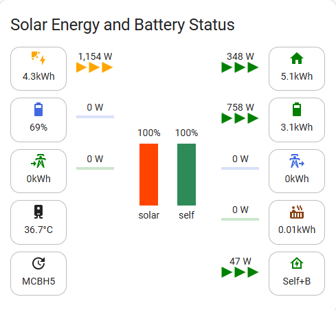

I have added a template sensor being the calculation, from the inverter-reported values
Delta (imbalance) = Solar + Import + Discharge - Export - Charge - Load
That is my ‘47 W’ shown bottom right.
In theory this should be 0. It is not, often due to timing differences between the reported figures, as not all power reading sensors update at exactly the same time. However when the load and solar generation are relatively stable, and not much else is happening, the difference given is the imbalance in the equation, which I assume to be the inverter power consumption. To be quite clear, this value (inverter self-consumption power) shows here simply because my inverter is not taking into account its own power use by subtracting it from any other figure that it reports.
This value could then be reported as consumption by a ‘device’ if you so wish (although I find it is far too unreliable and unstable as a figure for any practical use).
