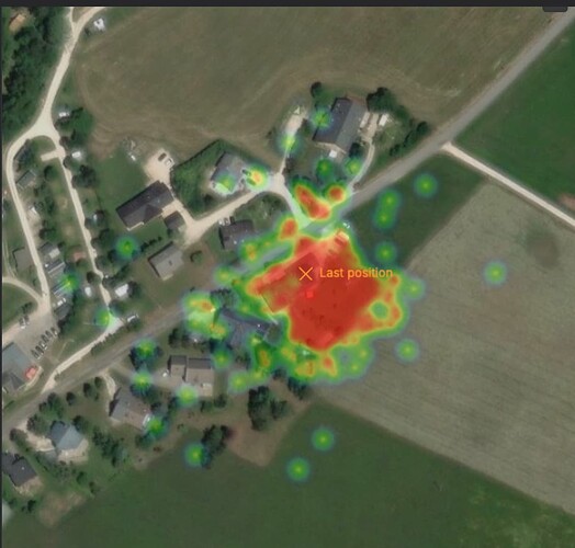

Maybe we can get something that looks like the Tractive apps using InfluxDB and Grafana. Grafana has a maps feature and I believe it can do heat maps. It’s not HA native though.

I did get it working with influxdb / grafana.
It’s not a plug&play solution, requires tinkering.
IIRC, here is what I did:
SELECT
last("latitude") AS lat,
last("longitude") AS lon
FROM "state"
WHERE ("entity_id" = 'taiga_tracker' # replace this with the entity ID of the device tracker created by the Tractive integration. Ex: for device_tracker.taiga_tracker, just enter taiga_tracker
AND "latitude"::field > 0 OR "latitude"::field < 0)
AND $timeFilter
GROUP BY time($__interval) fill(null)
