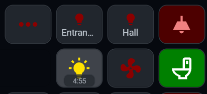

I have a front page on Lovelace with almost all switches to save space. I want to have the remaining time of timers on each button. I managed to use an example from a custom button card that enables us to add overlaying layers over the button but the returned value is the remaining time in the event of turning it, the time is not counting down but remains the same 0:05:00. The number 4:38 is a working timer in a different field, which I would like to move to its button. So all lights and fans controlled by timers will have the count down overlaying the icon.

ok, so I managed to make a sensor from an entity attribute “remaining” using the modern method but it keeps its value at 00:05:00 despite the timer counting down, so the time pattern method to refresh the sensor would not work. Yes, I tried to refresh it in developers tools.
So the way forward would be to update the returned value somehow.
Solved without any template sensor, just with code in the particular button card. Attribute remaining surprisingly is not a remaining time, what is it remains a question. See here.

Great, would you mind sharing your button card? Would like to apply this for a minute count-down timer.
Sorry for late reply. However, the button card code is in the post above.
Did you manage to get this countdown timer working?
yes, as I said, the code is above
