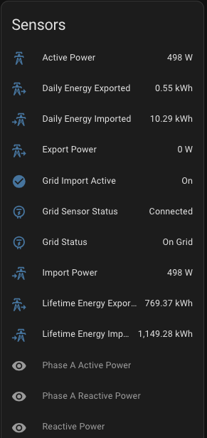

I’m using Sigenegy2MQTT add-on but I expect it will be the same for the Modbus integration. These are the sensors I have for the grid energy sensor in the gateway:
thats great, thanks.
‘Grid Status’ is clearly the parameter I need there, so just need the extra modbus-eth converter to arrive tomorrow and I should be good to play around on this.

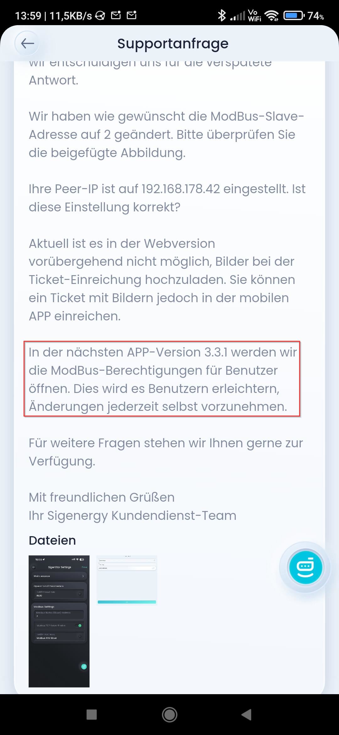

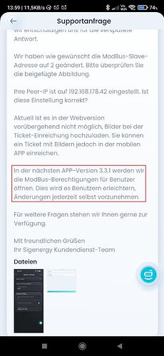

I have some news here:
→ Sigenergy states that they will open Modbus for users, starting from V3.3.1.

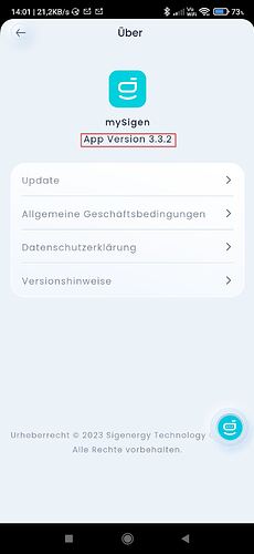

Unfortunately I already have V3.3.2, I should thus see Modbus settings:
But I don’t see the slightest hint of Modbus in the App. However I could finally connect to the Modbus-Interface in HA and I can see the values now. This cost me some discussion with the technical support and some notification (what is the IP of the primary inverter?), but in the end it worked.

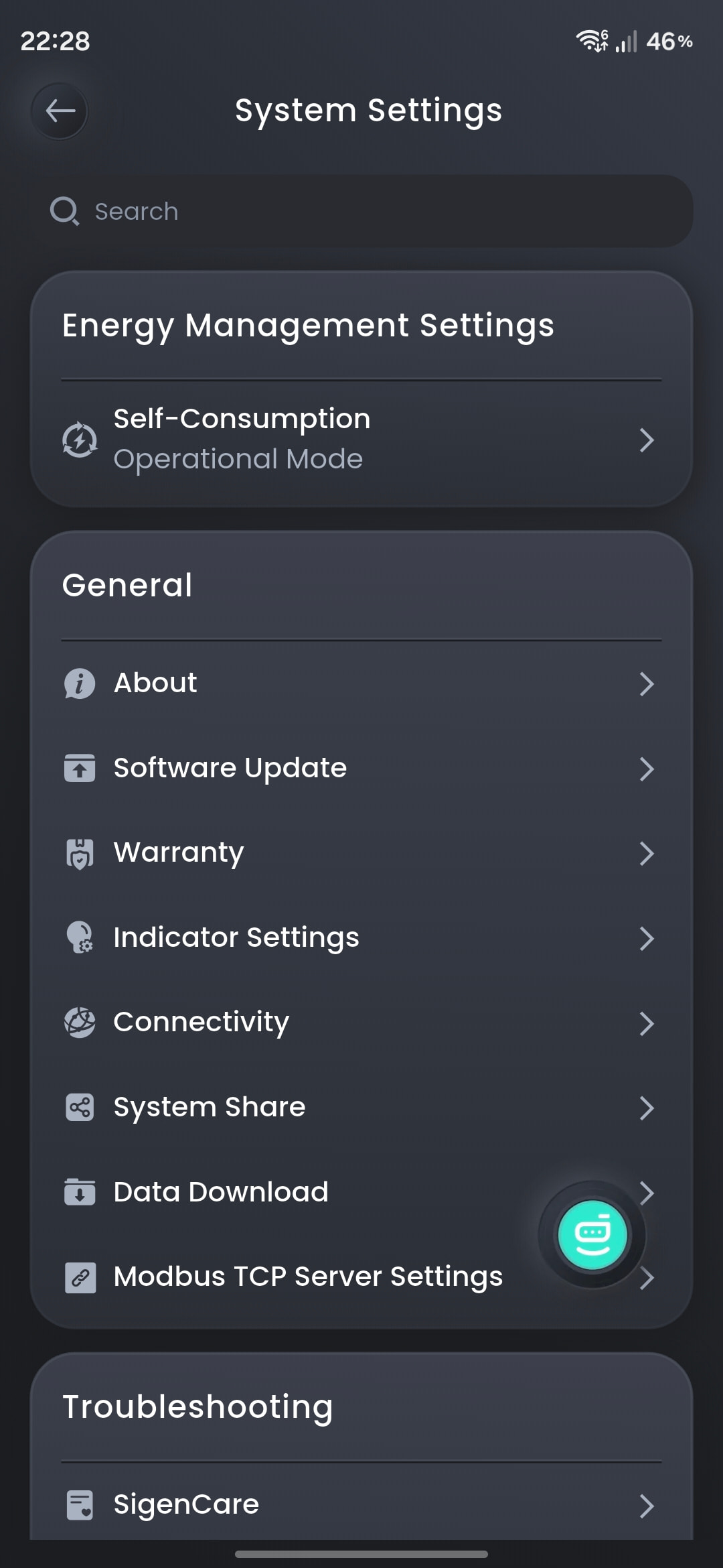

In the latest version of the app (3.6.2) you can enable modbus now.
