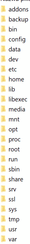

I am able to access HA with SSH and here is the list of directories I can see:
Was trying to search in some of them for manufacturer_specific.xml file with no luck :frowning:
