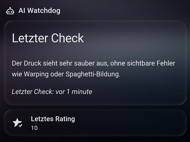

Works like a charm, and the Gemini free tier seems to be enough for this. I added a couple of helper entities to save the rating and description so I can display them directly on the dashboard. Love it – thanks a lot for your work!
Can you give examples in the helpers you added ?
