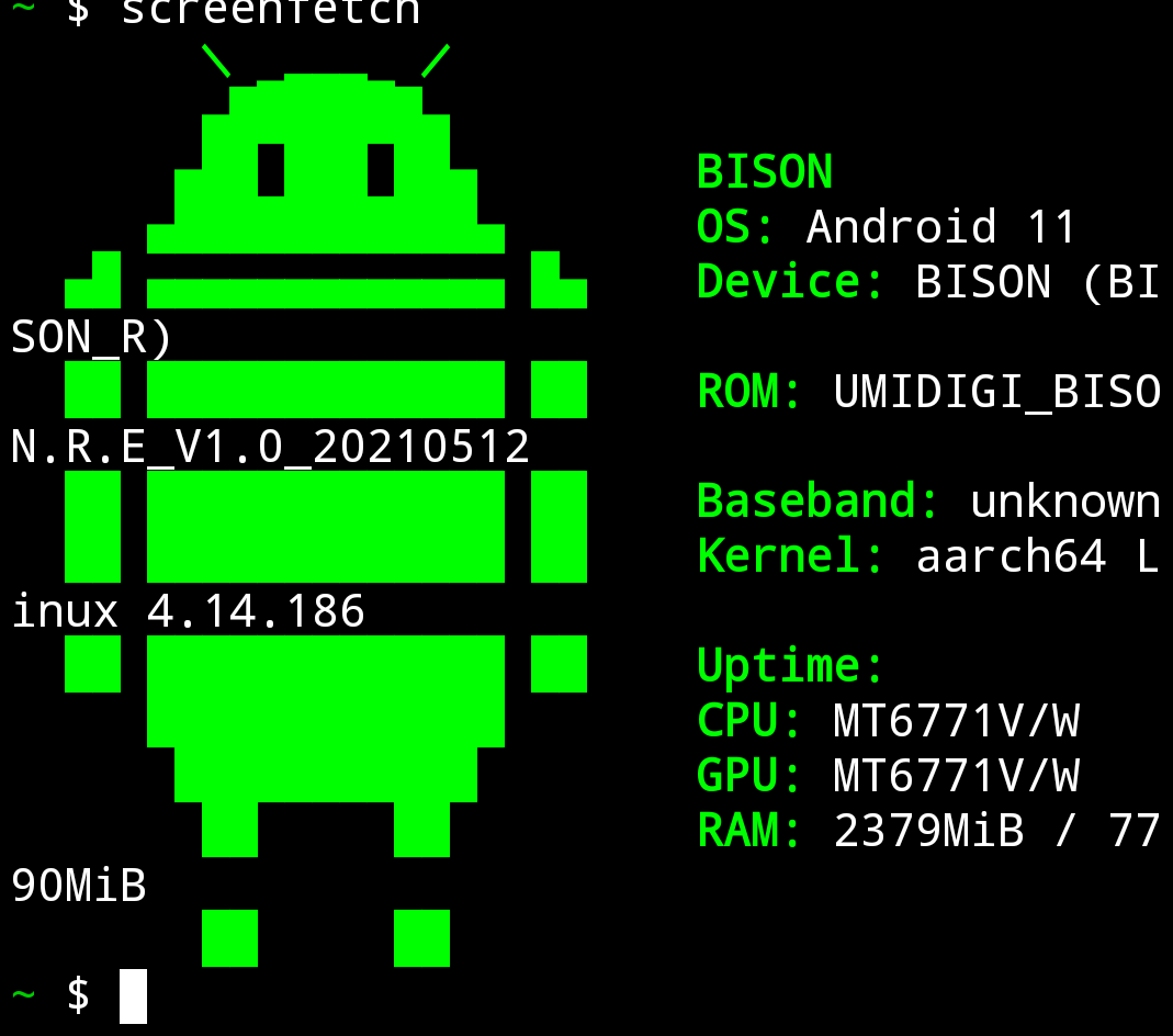

Got an old Android phone and don’t want to buy a Raspberry Pi or a PC to host Home Assistant? This tutorial is for you!
Requirements: Android Phone – No Root Required

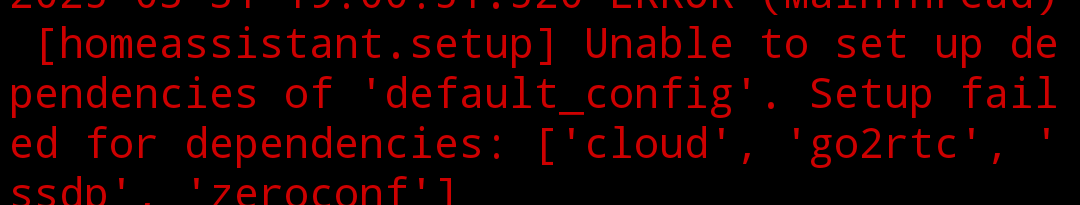

:bangbang: Known Issue: Home Assistant setup failed for some dependencies, including ‘bluetooth,’ ‘usb,’ ‘zeroconf,’ etc. :robot::wrench: Any help would be appreciated! :pray:

When running “home-assistant-core.sh”, I get:
ERROR (MainThread) [homeassistant.setup] Error during se tup of component http: [Errno 13] Permission denied
 File "/usr/src/homeassistant/homeassistant/setup.py", line 422, in _async_setu                           p_component
    result = await task
  File "/usr/src/homeassistant/homeassistant/components/http/__init__.py", line                            264, in async_setup
    local_ip = await source_ip_task
  File "/usr/src/homeassistant/homeassistant/components/network/__init__.py", li                           ne 48, in async_get_source_ip
    adapters = await async_get_adapters(hass)
  File "/usr/src/homeassistant/homeassistant/components/network/__init__.py", li                           ne 33, in async_get_adapters
    network: Network = await async_get_network(hass)
  File "/usr/src/homeassistant/homeassistant/helpers/singleton.py", line 67, in                            async_wrapped
    result = await func(hass)
  File "/usr/src/homeassistant/homeassistant/components/network/network.py", lin                           e 39, in async_get_network
    await network.async_setup()
  File "/usr/src/homeassistant/homeassistant/components/network/network.py", lin                           e 65, in async_setup
    self.adapters = await async_load_adapters()
  File "/usr/src/homeassistant/homeassistant/components/network/util.py", line 2                           7, in async_load_adapters
    for adapter in ifaddr.get_adapters()
  File "/usr/local/lib/python3.13/site-packages/ifaddr/_posix.py", line 56, in g                           et_adapters
    raise OSError(eno, os.strerror(eno))
PermissionError: [Errno 13] Permission denied

2025-03-20 03:57:46.074 ERROR (MainThread) [homeassistant.setup] Setup failed fo                           r 'energy': Could not setup dependencies: websocket_api, history
2025-03-20 03:57:46.074 ERROR (MainThread) [homeassistant.setup] Unable to set u                           p dependencies of 'logbook'. Setup failed for dependencies: ['frontend', 'http']
2025-03-20 03:57:46.075 ERROR (MainThread) [homeassistant.setup] Setup failed fo                           r 'logbook': Could not setup dependencies: frontend, http
2025-03-20 03:57:46.075 ERROR (MainThread) [homeassistant.setup] Unable to set u                           p dependencies of 'my'. Setup failed for dependencies: ['frontend']
2025-03-20 03:57:46.075 ERROR (MainThread) [homeassistant.setup] Setup failed fo                           r 'my': Could not setup dependencies: frontend
2025-03-20 03:57:46.075 ERROR (MainThread) [homeassistant.setup] Unable to set u                           p dependencies of 'stream'. Setup failed for dependencies: ['http']
2025-03-20 03:57:46.075 ERROR (MainThread) [homeassistant.setup] Setup failed fo                           r 'stream': Could not setup dependencies: http
2025-03-20 03:57:46.084 ERROR (MainThread) [homeassistant.setup] Unable to set u                           p dependencies of 'application_credentials'. Setup failed for dependencies: ['au                           th', 'websocket_api']
2025-03-20 03:57:46.084 ERROR (MainThread) [homeassistant.setup] Setup failed fo                           r 'application_credentials': Could not setup dependencies: auth, websocket_api
2025-03-20 03:57:46.084 ERROR (MainThread) [homeassistant.setup] Unable to set u                           p dependencies of 'analytics'. Setup failed for dependencies: ['api', 'websocket                           _api']
2025-03-20 03:57:46.084 ERROR (MainThread) [homeassistant.setup] Setup failed fo                           r 'analytics': Could not setup dependencies: api, websocket_api
2025-03-20 03:57:46.159 ERROR (MainThread) [homeassistant.setup] Unable to set u                           p dependencies of 'tts'. Setup failed for dependencies: ['http']
2025-03-20 03:57:46.161 ERROR (MainThread) [homeassistant.setup] Setup failed fo                           r 'tts': Could not setup dependencies: http
2025-03-20 03:57:46.201 ERROR (MainThread) [homeassistant.setup] Unable to set u                           p dependencies of 'assist_pipeline'. Setup failed for dependencies: ['conversati                           on', 'stt', 'tts']
2025-03-20 03:57:46.201 ERROR (MainThread) [homeassistant.setup] Setup failed fo                           r 'assist_pipeline': Could not setup dependencies: conversation, stt, tts
2025-03-20 03:57:46.316 ERROR (MainThread) [homeassistant.setup] Unable to set u                           p dependencies of 'mobile_app'. Setup failed for dependencies: ['http', 'intent'                           , 'person', 'webhook', 'websocket_api']
2025-03-20 03:57:46.318 ERROR (MainThread) [homeassistant.setup] Setup failed fo                           r 'mobile_app': Could not setup dependencies: http, intent, person, webhook, web                           socket_api
2025-03-20 03:57:46.368 ERROR (MainThread) [homeassistant.setup] Unable to set u                           p dependencies of 'default_config'. Setup failed for dependencies: ['assist_pipe                           line', 'bluetooth', 'cloud', 'conversation', 'energy', 'go2rtc', 'history', 'log                           book', 'media_source', 'mobile_app', 'my', 'ssdp', 'stream', 'usb', 'webhook', '                           zeroconf']
2025-03-20 03:57:46.368 ERROR (MainThread) [homeassistant.setup] Setup failed fo                           r 'default_config': Could not setup dependencies: assist_pipeline, bluetooth, cl                           oud, conversation, energy, go2rtc, history, logbook, media_source, mobile_app, m                           y, ssdp, stream, usb, webhook, zeroconf
2025-03-20 03:57:46.731 WARNING (MainThread) [homeassistant.bootstrap] Detected                            that frontend did not load. Activating recovery mode
2025-03-20 03:57:47.455 ERROR (MainThread) [homeassistant.setup] 2025-03-20 03:5                           7:47.455 ERROR (MainThread) [homeassistant.setup] Error during setup of componen                           t http: [Errno 13] Permission denied
    result = await task

Additionally… I got back the Alcatel phone and I was wondering, that It is an Android11 phone and I can read /proc/net/dev file on it.
~ $ screenfetch
     ▄███████████▄       OS: Android 11
  ▄█ ▄▄▄▄▄▄▄▄▄▄▄▄▄ █▄    Device: 5033F (Macau)
  ██ █████████████ ██    ROM: RP1A.200720.011 release-keys
  ██ █████████████ ██    Baseband: unknown
  ██ █████████████ ██    Kernel: armv7l Linux 4.14.186-00011-ge8ae332-dirty
  ██ █████████████ ██    Uptime:
     █████████████       CPU: MT8765WA
      ███████████        GPU: MT8765WA
       ██     ██         RAM: 553MiB / 870MiB
~ $ cat /proc/net/dev
