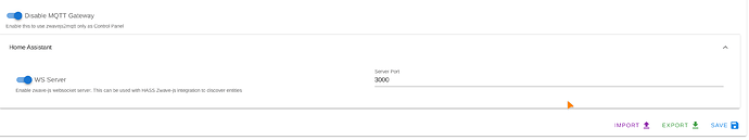

in the web UI is where you’ll specify your network key, it’s not immediately obvious but if you had something like
0xBA 0xDE 0xCE …
it should be
BADECE
inside the web UI there’s a configuration setup to enable for “home assistant” just enable it then you’ll be good to go to meet @rveachkc original request of doing this without mqtt.
