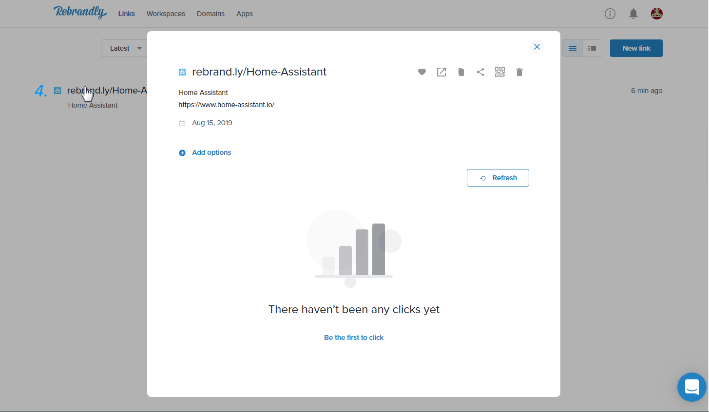

  1. Click on the link you created to open its properties(?) page.
  1. Copy and save the last segment of the URL from your browser address bar. This is the link id that their API will use to update the URL.
