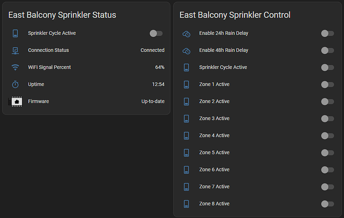

  • Home Assistant integration allows:
    • System status
    • Manual zone controls for testing
    • Ability to set schedule

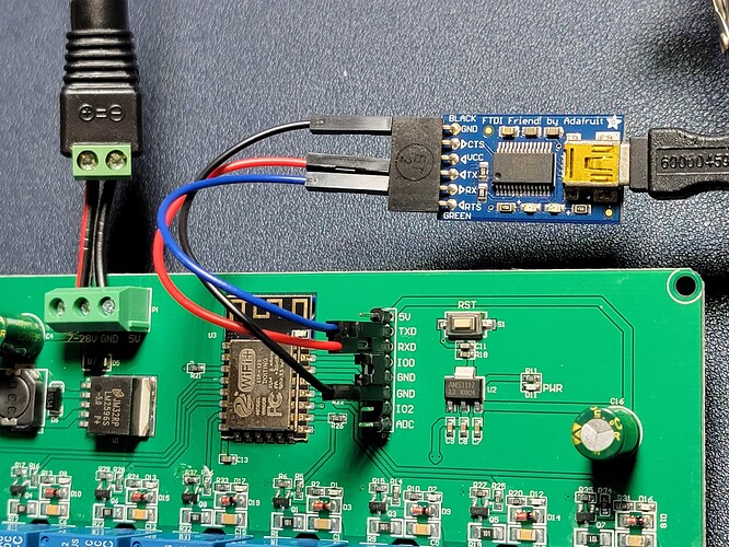

The relay board:
This ESP8266 8 Channel Relay board is just the ticket. Sure, it costs slightly more than an ESP8266 and a separate 8 channel relay PCB, but you don’t have to assemble multiple parts into a project box, so you can build this project in a snap!
Here’s a picture of the board, nice and tidy!

An optional modification to the PCB:
I want this PCB to supply 24V to my sprinkler valve, just by simply hooking it up directly to the screw terminals, just like an off-the-shelf commercial product. To that end, I’ve added some jumper wires inside to supply 24V to the output of the relay.
This is totally optional, but makes for a cleaner install. If you don’t do this, you will just have to find some other way to provide the 24V to your valve, and put the relay in series.
Here you can see the unmodified board. I have labeled the relay outputs NO (normally open) COM (common) and NC (normally closed) in the bottom left.
Wire GND to all NC terminals.
Wire 24V to all NO terminals.
Consider filling the NO screw terminal with hot glue, as it will always be energized and it won’t be needed for this application.
With this jumper wire configuration:
GND will always be connected to NC terminals.
When the relay is energized, 24V will be connected to COM terminals.
When the relay is not energized, GND will be connected to COM terminals.

Initial Flash with ESPHome
Connect your FTDI to GND, RX to TX and TX to RX. Do not connect 5V to FTDI.
Set your FTDI for 3v programming, not 5v. (thanks to comments below)
Connect an external power supply to the board, you can use your 24VDC power supply connected to the 7-28V input.
Plug the supplied pin jumper between GND and IO0.
Here’s what it looks like:
Steps:
  1. Load the YAML into your ESPHome web interface.
  2. Start with the FTDI USB unplugged, and the board external power disconnected.
  3. Hold the RST button on the board.
  4. Plug in the external power source (24V DC plug).
  5. Plug your FTDI USB into your PC.
  6. In ESPHome, click install via wired connection.
  7. Release the RST button.
  8. The web interface should begin the upload. If it fails, try again.
If the installation hangs up and fails, it may be because you are not supplying enough power. You must power the board from an external source, not the from the FTDI.
Once the flash is successful, unplug the FTDI, disconnect external power, and remove the jumper. Plug it back in to 24V DC power and the device should connect to WIFI. Shortly thereafter you should see a notification in Home Assistant that your new device has been discovered. Go ahead and add it!
You can test each relay right away by toggling the zones.

Home Assistant Dashboard Setup
Here’s a simple dashboard with all of the controls:
Here’s the YAML configuration for a basic Home Assistant dashboard:
Status Card
type: entities
  - entity: switch.east_balcony_sprinkler_cntrl_sprinkler_cycle_active
    name: Sprinkler Cycle Active
  - entity: binary_sensor.east_balcony_sprinkler_cntrl_connection_status
  - entity: sensor.east_balcony_sprinkler_cntrl_wifi_signal_percent
    name: WiFi Signal Percent
  - entity: sensor.east_balcony_sprinkler_cntrl_uptime
  - entity: update.east_balcony_sprinkler_controller_firmware
title: East Balcony Sprinkler Status
show_header_toggle: false
Control Card
type: entities
  - entity: switch.east_balcony_sprinkler_cntrl_enable_24h_rain_delay
    name: Enable 24h Rain Delay
  - entity: switch.east_balcony_sprinkler_cntrl_enable_48h_rain_delay
    name: Enable 48h Rain Delay
  - entity: switch.east_balcony_sprinkler_cntrl_zone_1_active
    name: Zone 1 Active
  - entity: switch.east_balcony_sprinkler_cntrl_zone_2_active
    name: Zone 2 Active
  - entity: switch.east_balcony_sprinkler_cntrl_zone_3_active
    name: Zone 3 Active
  - entity: switch.east_balcony_sprinkler_cntrl_zone_4_active
    name: Zone 4 Active
  - entity: switch.east_balcony_sprinkler_cntrl_zone_5_active
    name: Zone 5 Active
  - entity: switch.east_balcony_sprinkler_cntrl_zone_6_active
    name: Zone 6 Active
  - entity: switch.east_balcony_sprinkler_cntrl_zone_7_active
    name: Zone 7 Active
  - entity: switch.east_balcony_sprinkler_cntrl_zone_8_active
    name: Zone 8 Active
title: East Balcony Sprinkler Control
