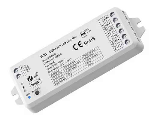

I bought this:
which works as a switch/dimmer in HA but I cannot use my existing wood penetrating switch.

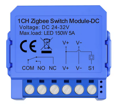

I also bought this:
which I haven’t received yet. But AFAIK I will just be able to turn it on/off via HA and not dim it.

Can you dim your Tuya controlled LEDs down to zero? Is this working in HomeAssistant?
What is a “wood penetrating switch”?
Your blue box looks like a ZigBee relay/switch device, not a dimmer. This should be able to be set up to work in HomeAssistant.
What do you want to do?
I can dim the WZ1 to 0 light.

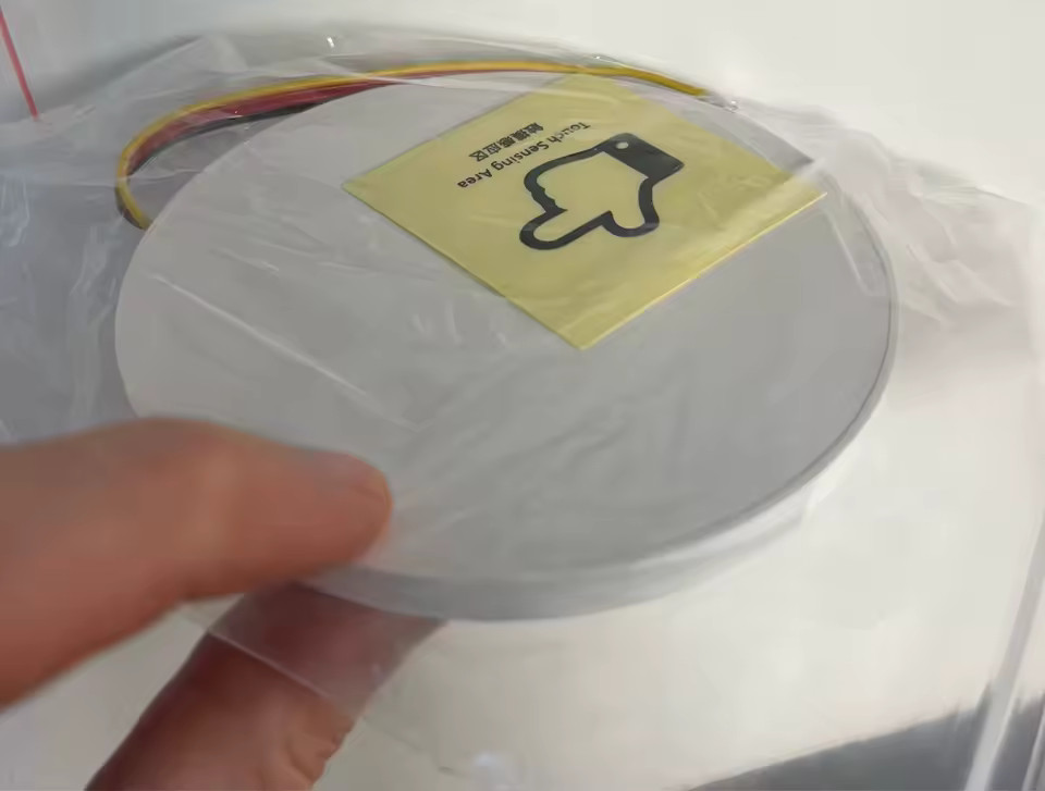

“Wood penetrating switch/dimmer” is basically a capacittive sensor that can be placed below the e.g. desk and controlled by tapping the top of the desk. “Wood penetrating” is not a correct term (sorry for not being more specific). But the sensor senses the gestures through materials.
You are correct. The blue box is a relay/switch device and not a dimmer. With it I would be able to turn on/off the LED in HA, while also use the existing capacitive sensor to turn on/off the LED as well as dim. (At least this is my assumption)

First you need to open the touch dimmer casing to see if the PCB has jumpers to set it in simple switch mode.
If it’s like this you have some chances…
