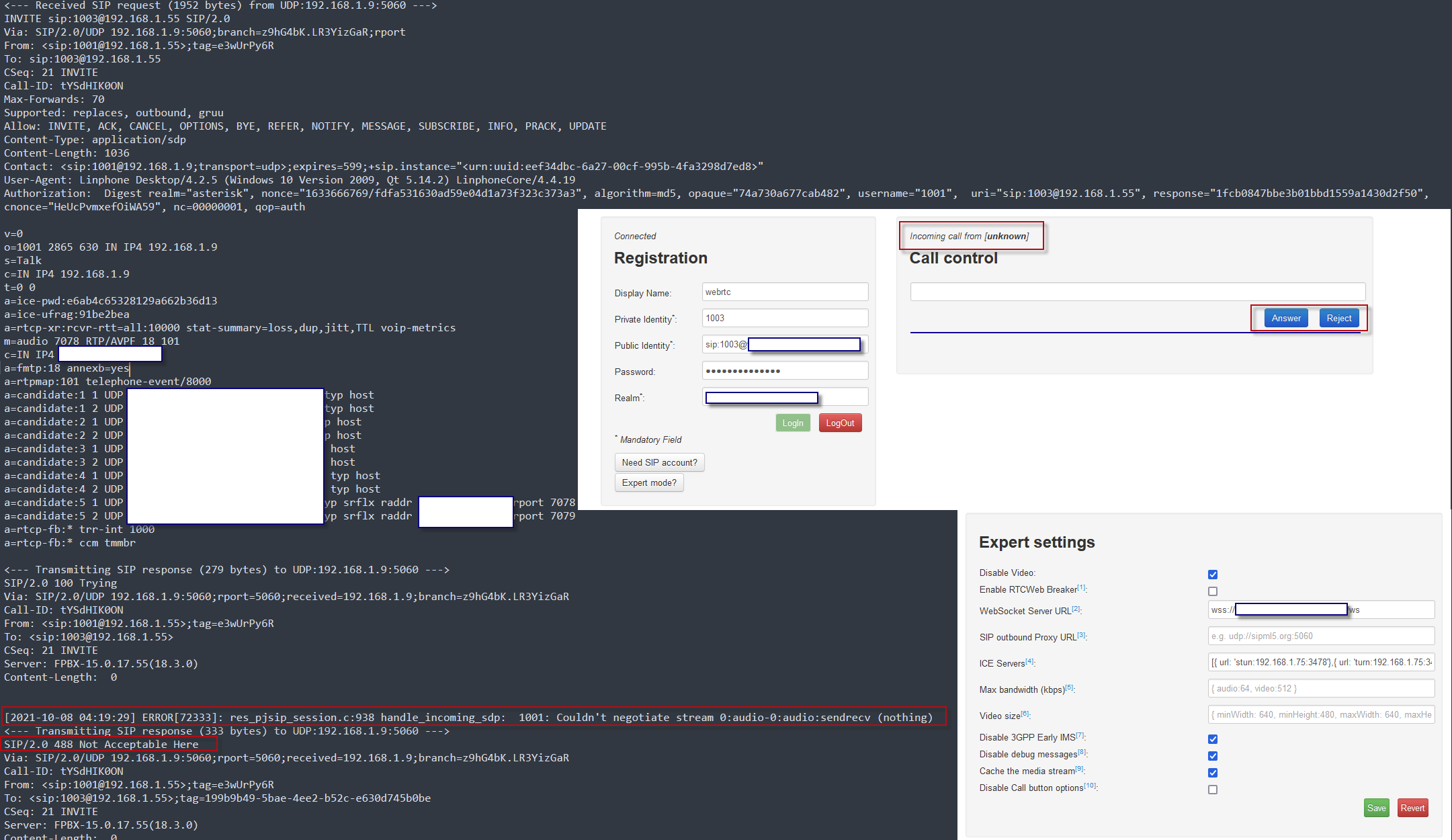

So, first of all, allow me to explain my setup. I am using an Rpi4 with ubuntu server. All the services like homeassistant, freepbx(asterisk), turn/stun server, … are installed inside docker containers. Also for networking for the docker containers, i am using macvlan and also a bridge macvlan from host to containers to allow local communication.
Now, onto the freepbx(asterisk) part. This are the logs from pjsip debug. But if i do use sipML5 with stun/turn server it works as intended. See image bellow.
My guess is that the networking setup prevents the doordroid card to register on asterisk. However, I have no experience with this kind of setup (docker, stun server,…) so I might be completely wrong.
You could try making things simpler by eg. running asterisk in “host” mode or directly on the server.
I understand that the screenshot are from SIPML5. You are putting there ICE server, something you can’t do with the doordroid card.
I took a look at your log, it looks like the error SIP 488 Not Acceptable Here along with the couldn't negotiate stream has to do with the codec negotiation. However I don’t see any pjsip debug messages with your webrtc client.
