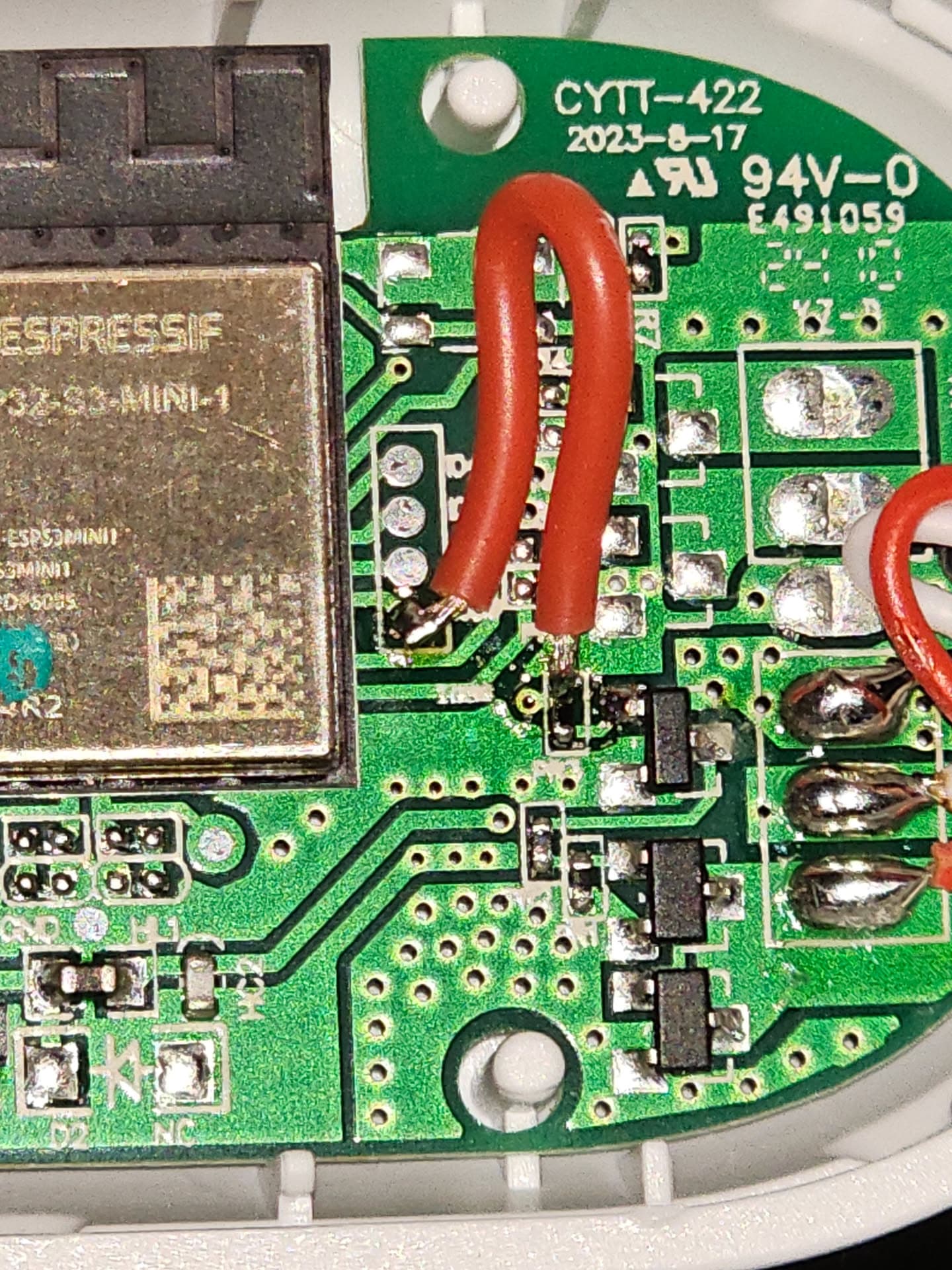

I just bought one of the Lepro N1 led strips. I decided to open it up and was very pleased to see that internally, it is all controlled by an ESP32-S3-MINI-1, so I am planning on reflashing it with something that plays nicely with HA, such as WLED. I’ll post an update here once I’ve tried that.
Progress update. I’ve built wled for the esp-32-s3-mini and managed to flash it. Through trial and error, I’ve discovered that the esp uses IO11 to send data to the lights. Unfortunately, that wasn’t enough to get the lights working. I cut the far end of the light strip open so I could see what chips they are using and yes, they are using WS2811, so they should play nicely with wled. I quickly discovered that, even though data is being sent to the light strip, the power (24v) was not. After close inspection I found a coiuple of MOS-FETS close to the power output and again, through trial and error, discovered that IO38 is being used to switch the power to the strip on and off. That explains why the light strip doesn’t work.
I think the easiest way to get around this is to create a simple wled usermod, which can be configured to drive an arbitrary IO pin to 1 or 0. This makes for a usermod that may be useful to others wanting to get wled to run on custom hardware. I’ve just started looking at how to write a usermod so will report back here when I’ve figured that out. I’m now very confident that I’ll soon have wled running in place of the original firmware.
So wled is now running fine. I’ve a bit of tidying up to do with my wled usermod and then I’ll make it available.
Still to do - see if I can figure out how to make use of the onboard microphone.
I just bought this, encouraging that someone else already did most of the work for me.
An improvement, if you’d call it that, is that you can use the relay config option to do what you’re talking about. I tried IO38 with no luck, rather than search for the actual pin, I made the connection myself. With that, no custom firmware is needed.
