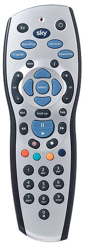

Hi, first post on a project share so hopefully its in the right place.
Inspired by the inclusion of the new SKY integration I was keen to experiment with my old SKY+ HD Box to create a frontend control panel.
Just a novice but It seems to now function to my requirements so sharing for others to improve.
The image above shows two versions of code. On the left no titles are used so clicking the buttons of the image will perform an action. The image on the right has the titles shown so could be used to setup other SKY remote styles adjusting the title positions.
The remote i.p will need to be changed in the code and the skyremote.png placed in a folder.
Mine is in /local/images/
Save the image below.
Code for remote without text labels

image: /local/images/skyremote.png
grid_options:
  columns: 8
  rows: auto
Hopefully it’s of use to someone. I’m keeping the older SKY+ Box for various reasons.
Thanks
Thanks for this. Works perfectly. I too still have a HD box for… reasons. Now it would be great to make a media player integration. There is plenty of information output on the RS232 port for this. Just need to parse it properly.
Delighted that I have found this, and thank you for providing your solution! Sometimes we watch Sky in a different room and the normal remote is unreliable. This will help a lot!
