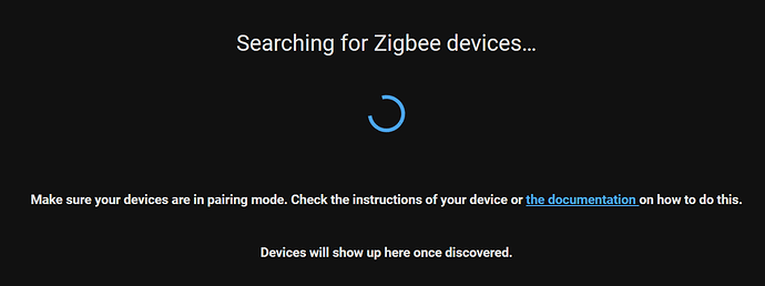

I wasted the last 3 hours and still haven’t gotten even 1 device to connect.
One person said 20cm. I’m literally touching the Skyconnect and my Zigbee devices together, and they won’t connect.
I’ve tried a 2m USB 2 cable, as well as a 15’ USB 3 cable. All of them plugged into a USB 2 jack on the Raspberry Pi.
My Logbook has nothing:
It’s correctly on channel 25 too!
My life consists of looking at this screen:

Regardless, I finally figured it out. The IKEA documentation was wrong. It said to hold for 10 or more seconds close to a Zigbee router. You actually need to press the link button 4 times in quick succession, then it turns red and starts to pair. You do need to be close to the device though.
After that, I was able to get everything working on multiple floors even with Channel 11 in use and 8 access points in my house!
