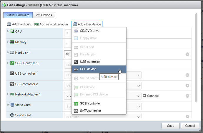

My VMware admin days are long behind me and I forgot that I needed to add the device to the guest OS. When going into the VM settings, even though the VM was powered off, the Add other device > USB device option was greyed out.
I’d checked the ESX host that it was connected:

And in the UI, the Add other device > USB device option was no longer greyed out:
The Silcon SkyConnect v1.0 device is connected:
