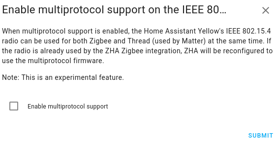

If the same browser and OS combination can connect other WebSerial devices, I’d try HASS itself:
Settings → System → Hardware → Configure → Enable multiprotocol support on the IEEE 802.15.4 radio
Works on a Yellow, but I’ve not got a SkyConnect to see if the feature works the same via seperate USB:
