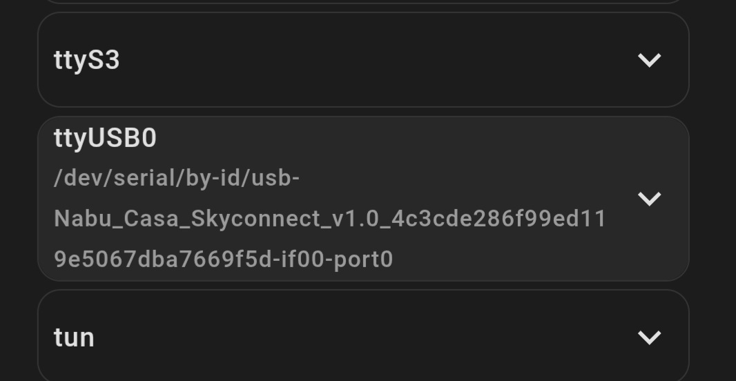

Hello
My guess is that you are using the short URL for talking to this port and not the longer serial/by-id one. The actual port can change internally at boot time, where the longer URL is linked directly to the device.
The TTY ports can sometimes change internally, so it is suggested to use the /serial/by-id/ URL that always talks to your dongle by serial so it is always right.
You can find out that that is by using:
and looking for it under all hardware, something like this:

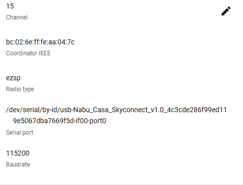

Hi there. Im still on older version but checked that out on it and seems like im using that serial/by-id/ path atleast on this. Version
Il test later to update again and test it out.
Your ZHA or Z2M software has to be addressing the longer URL. That message above was just telling you how to know what your longer URL is so that you can tell whatever application is talking to your dongle a better way to find it.
Oh yes. haven’t tested update yet but checked that ZHA is using long url on older instance.

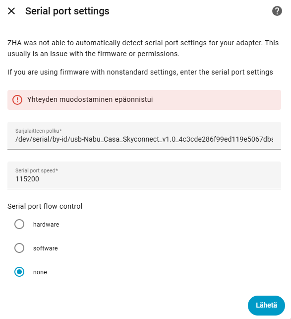

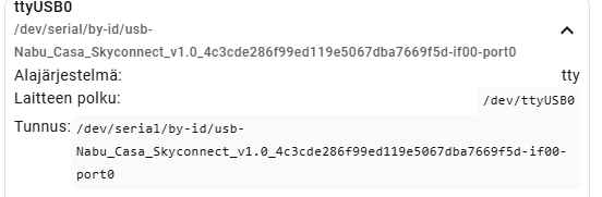

okay. tested again with new home assistant core. this is from system info it sees skyconnect
This is error:
And it only lets me reconfigure current router and just gets cannot connect to router error.
And this is in the logs
