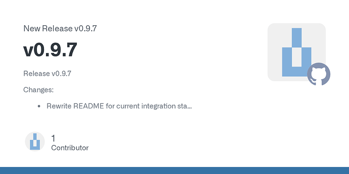

Small update: I have pushed a newer development release of the SkyRC MC3000 Home Assistant integration.
GitHub:
Latest release:
Current status in v0.9.7:
  • HACS-compatible custom integration
  • UI config flow with BLE discovery
  • monitoring for all 4 MC3000 slots
  • start / stop buttons per slot
  • refresh and stop-all buttons
  • expected-chemistry dropdown per slot as a start interlock
  • 10 second polling
  • voltage display precision improved
  • elapsed time formatted as H:MM:SS
  • Companion App Mode switch
The Companion App Mode is useful because the MC3000 appears to allow only one BLE client at a time. When enabled, Home Assistant disconnects from the charger and pauses polling, so the SkyRC companion app can connect and change charger programs/settings. When disabled again, Home Assistant reconnects and resumes monitoring.
Important limitation: the integration still does not program charge profiles, currents, chemistry, voltage cut-offs, capacity cut-offs, temperature cut-offs, etc. It only starts the program already configured on the MC3000. Full profile editing would require further reverse-engineering or extending the underlying skyrc-ble library.
I have only tested this with my own MC3000 setup. Testing, bug reports, PRs and suggestions are very welcome, especially from people with different firmware versions or related SkyRC chargers.

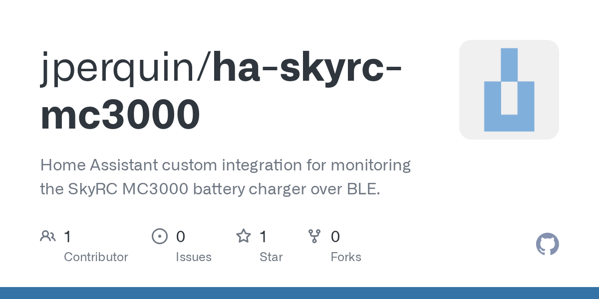

v1.0 beta / v0.10.0-beta is now available for testing
I have published a new beta release for the SkyRC MC3000 Home Assistant integration:
GitHub release: v0.10.0-beta
Repository: GitHub - jperquin/ha-skyrc-mc3000: Home Assistant custom integration for monitoring the SkyRC MC3000 battery charger over BLE. · GitHub
Main changes in this beta:
  • Home Assistant Bluetooth API support
  • ESPHome Bluetooth Proxy support
  • Auto Fetch Voltage Curves switch
  • manual voltage curve fetch buttons per slot
  • voltage curve diagnostic sensors per slot
  • voltage curve timing metadata from the MC3000 curve frame
  • ApexCharts dashboard example
  • improved voltage display precision
  • elapsed time formatting as H:MM:SS
The voltage curve support is read-only. The integration can start/stop programs already configured on the MC3000, but it does not yet write charger profiles or charge parameters.
For the dashboard graph, ApexCharts Card is required. An example YAML dashboard is included in the repository under:
examples/skyrc-mc3000-dashboard.yaml
Feedback and test reports are very welcome, especially from users running HAOS/VM setups with ESPHome Bluetooth Proxy.
