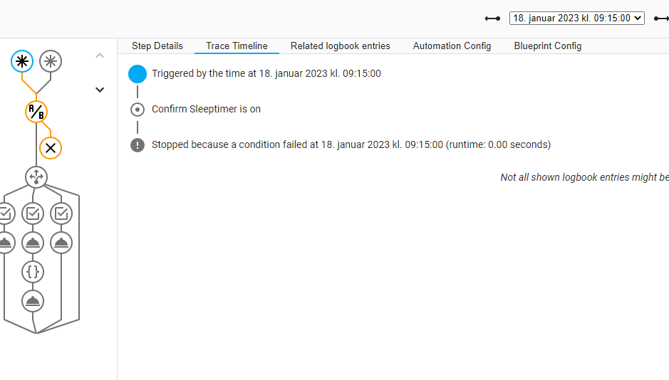

I’m not sure, you could check what’s under the choose step in the step details for that step, maybe that gives a hint? Otherwise you could download the trace of the failed run and upload it, I could have a look to see if I can find anything out of the ordinary.
It almost seems as if the ‘choose’ step is invalid, or at least the condition checks in it. Checking the step details should give you at least the values which were used during the run to check the conditions.

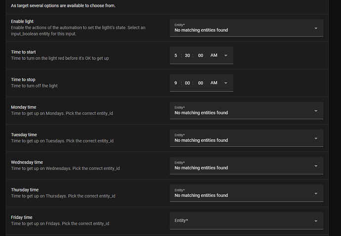

Just getting a chance to try again. This is probably something I’m missing, so apologies for the dumb questions, but how do I configure this to display something in then dropdown for ‘Enable light’? It says to select ‘input_boolen entity’ for this input, but nothing is in the dropdown. It just says "No matching entities found’. Same applies for each of the days of the week time where it says to select ‘entity_id’ and has no options other than again only displaying ‘No matching entities found’.
These helpers are useful because it makes it easy to setup on a dashboard in the UI, instead of having to dive in the automation itself to make any changes.
You can setup helpers from the UI in Settings → Devices&Services → Helpers. When the helper entities are setup, they should show up as possible entities to select in the automation’s setup.

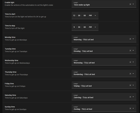

Hi! Thanks for a great blueprint! I have tried setting it up, but i think i am doing something wrong. I dont know if/how to configure the «on - input.boolean» helper. I tried adding it, but i guess i have done something wrong. The lamp turns on and off, but its just green. When the «start» time goes, it turns on green, not red. And it just keeps beeing green until stop time. Any suggestions to what ive done wrong?
Hi Lars,
Can you share your configuration? Do you mean the ‘Enable light’ boolean? If the light does turn on, then this input boolean is configured correctly.
Be aware that the times should be configured as input_datetime helper entities. It doesn’t work if you input the time directly in the automation configuration. It was setup in this way so that the times can easily be edited from the frontend.

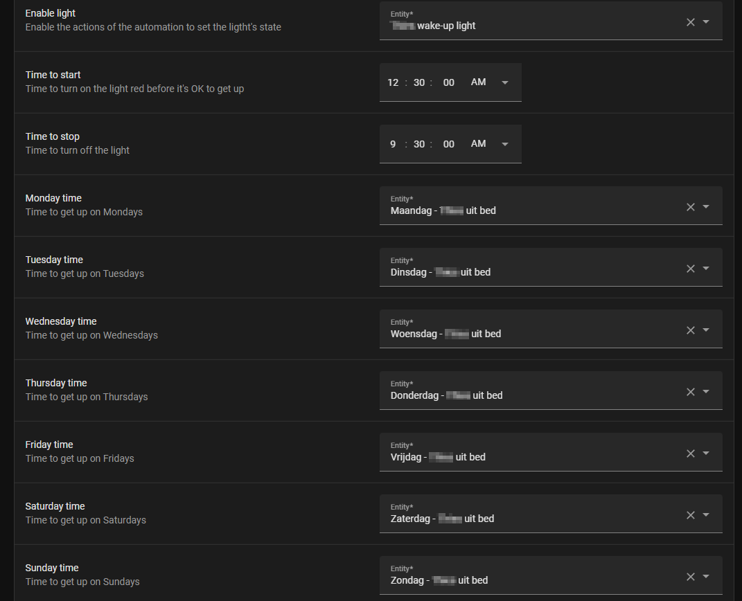

Hi Thanks for awnsering. Ive set up «weekdays» and «weekends» as time ‘input_datetime’

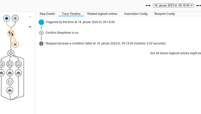

But i dont know why its not working. if i look at the steps, it “stops” between the “three pointet arrow” and the “A/B”
