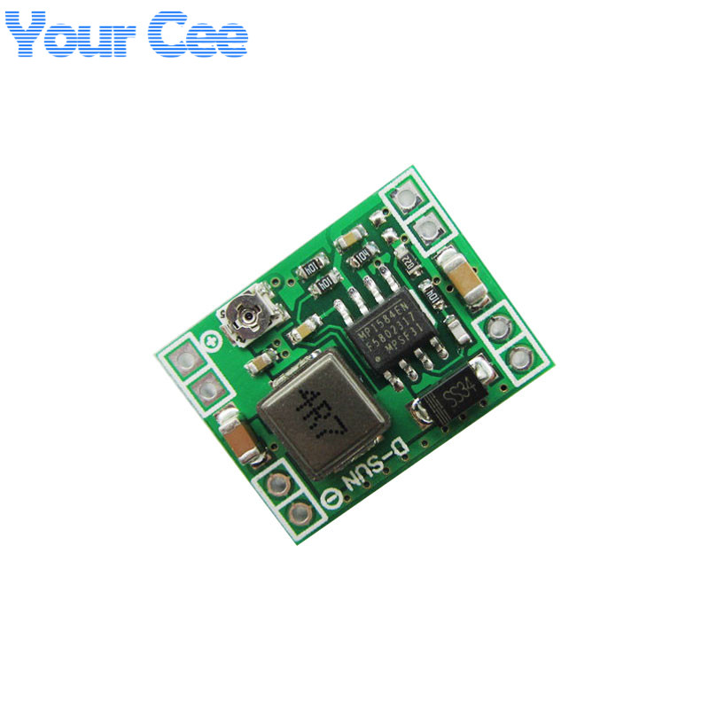

In my case I didnt have to handle mains voltage. In groundfloor I had already cable which provide 12V. Here I only had to add an buck converter to reduce the voltage to 5V (https://en.wikipedia.org/wiki/Buck_converter).
And upstairs I used a normal USB Power Supply with an self assembled USB cable. Only reason why I assembled myself was, that I wanted to keep the whole in the wall as small as possible.

As said i used the place where the intercom was hanging before. The intercom was driven by a 12V MeanWell PSU which is mounted in the basement in the “fusebox/controlbox” (German: Sicherungskasten). It’s a PSU like this:
https://www.mouser.de/ProductDetail/MEAN-WELL/DR-100-12?qs=TaOZSEYtRiXXOXb8a1blsg==
I just used a multimeter to determine which cable where +/- and then I used a cheap buck converter from AliExpress to reduce the Voltage. I dont think it matters too much which one you choose (please correct me if iam wrong). For example one like this:
