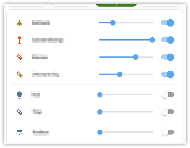

I have added a few sliders for the temperature settings, and I was thinking about a slider that doesn’t seem to exist…
Here is how it is today:
I’d like to merge the heat and cool temp on the same slider, that would look like this (photoshop’d):
Anybody here would know how to do it?

Is it possible to make de layout and colors the same as the ‘entities’ card?
Then you can place multiple sliders one below the other and everything looks the same on the dashboard.
