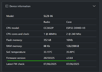

When you go to http://slzb-06, what firmware is displayed?
