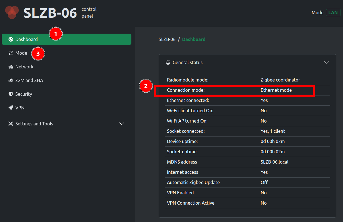

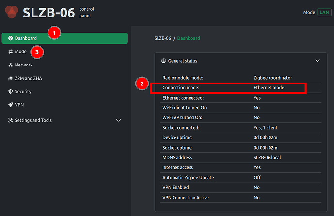

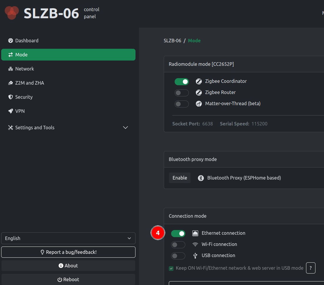

Found the issue. I looked at the dashboard again directly for the SLZB-06. I noticed that it stated that it is connected via USB. Went in the settings and changed it back to Ethernet. Once I did that the system started working again.
I don’t know how it changed to USB but somehow it did.

Thank you! I just had the same issue. I have my SLZB-06 powered over POE and it was mysteriously set up for USB mode all of a sudden.

Hi, @boltinbear BIG thanks for posting the logs (which made it easy for me to find this post) and the solution. I had the same problem where the Add-On would not start and I was struggling for 1 month+ to find a solution. Switching it from USB to Ethernet solved it right away (SLZB-06 dashboard > Mode > Connection Mode > Ethernet)
