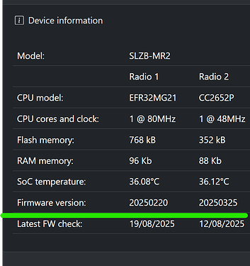

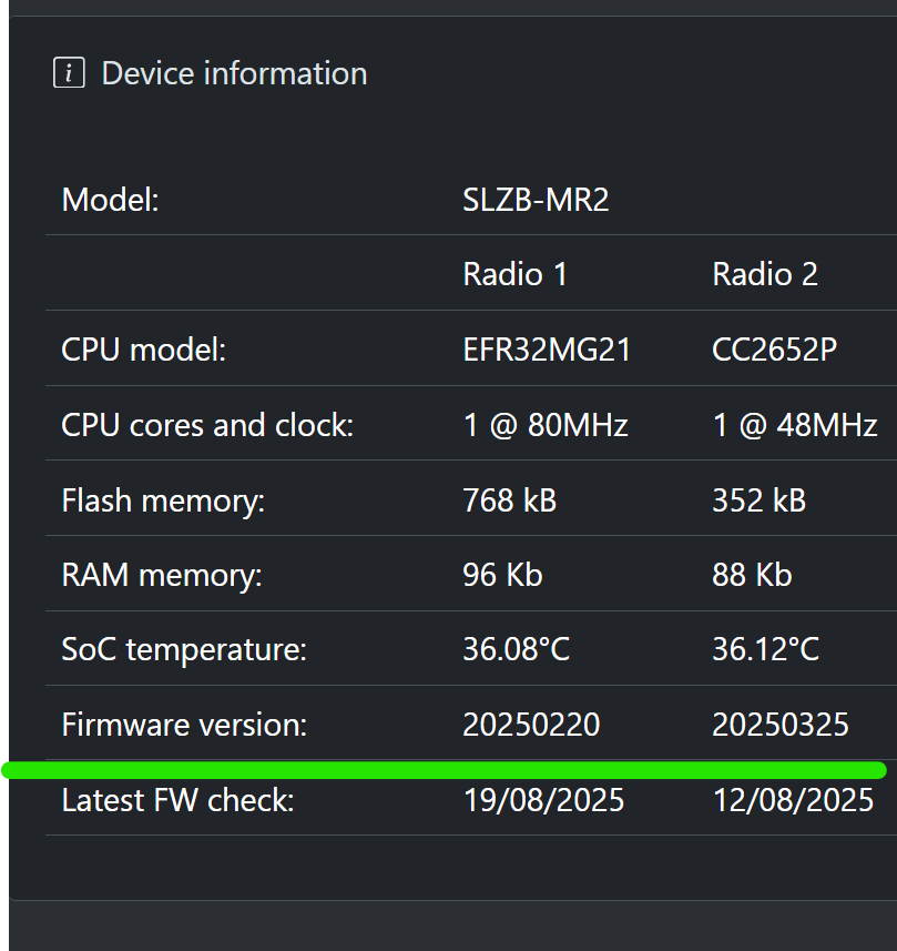

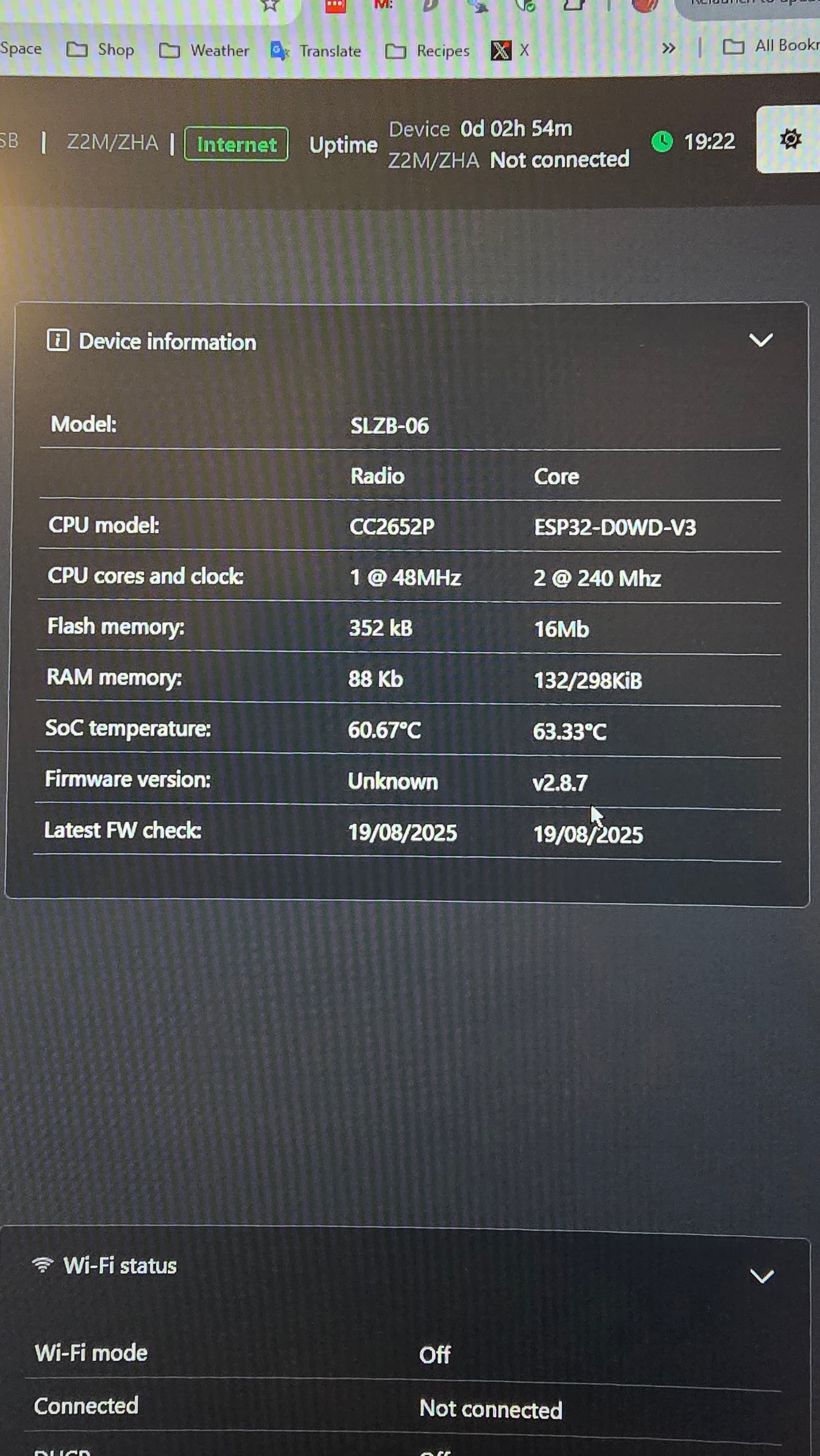

What firmware is active for the SLZB? It’s listed in the Dashboard
Should look be similar to this current firmware revision: 20250325
It’s connecting to the device so check your broker log too
Silly question, did you try physically powering down the SLZB stick and powering it back up?

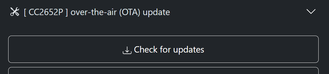

You radio firmware is the issue. Try re-flashing via the SLZB UI under Setting and Tools / Firmware Update
Select the menu with CC2652P

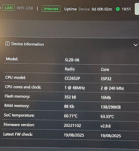

Ok, so i gone back to the latest 2.9.8 to start with as this seems mandatory to do anything else. Then done the update and it shows…
However, no change in HA, zigbee2mqtt still shows the same log errors.

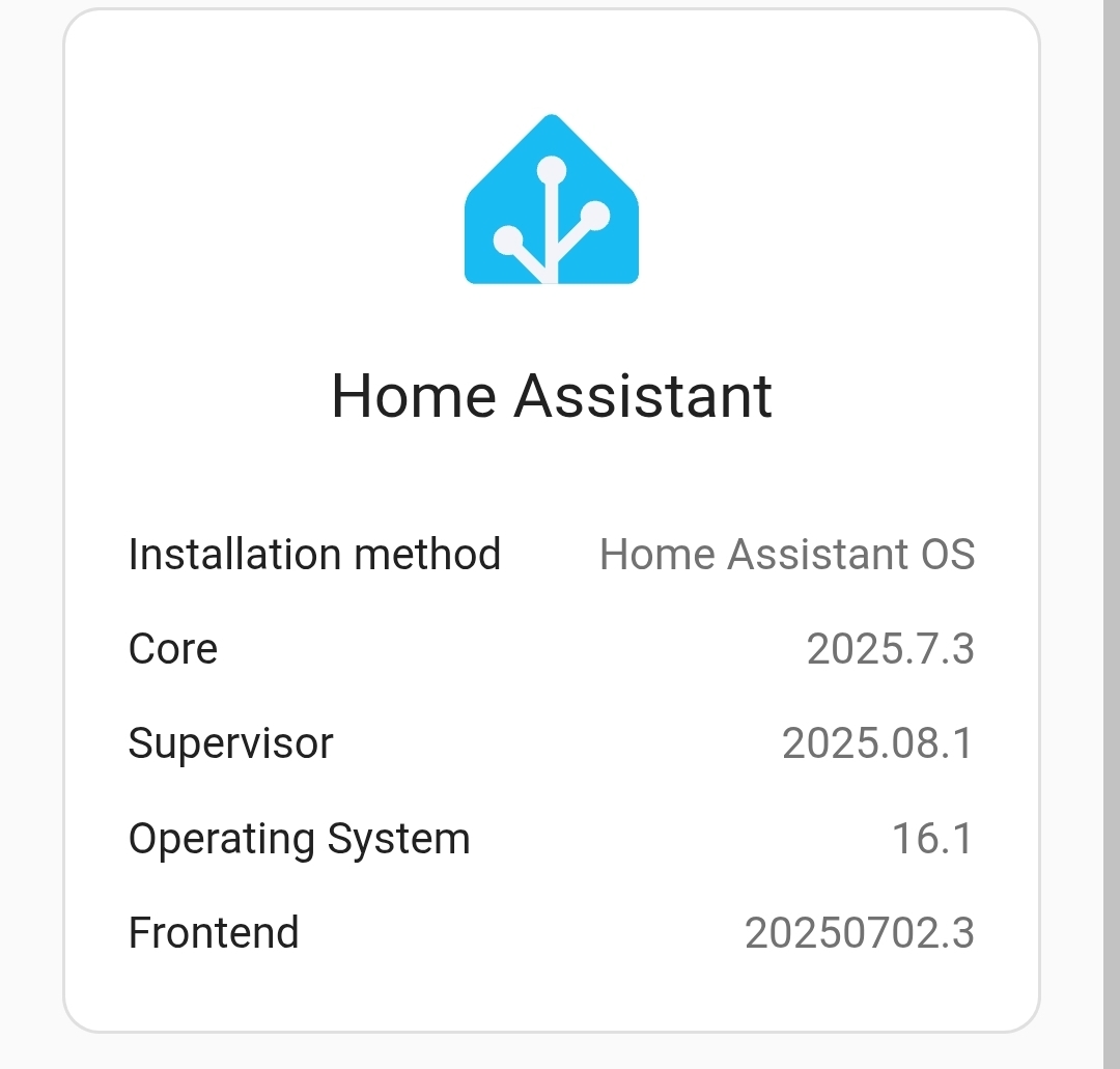

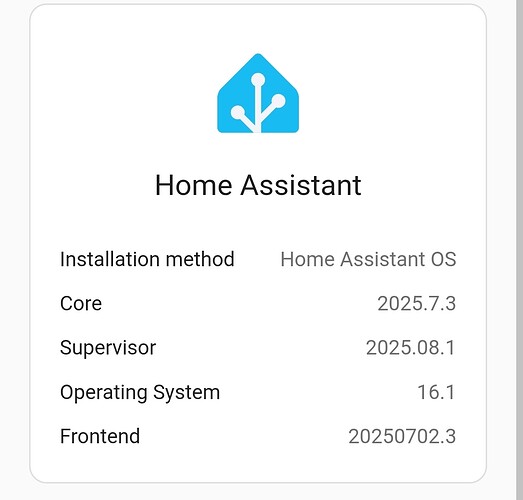

What install method are you using?
An Example
  • Installation method Home Assistant OS
  • Core 2025.8.2
  • Supervisor 2025.08.1
  • Operating System 16.1
  • Frontend 20250811.0
After the SLBZ update, did you reboot the system( not the restart option)?

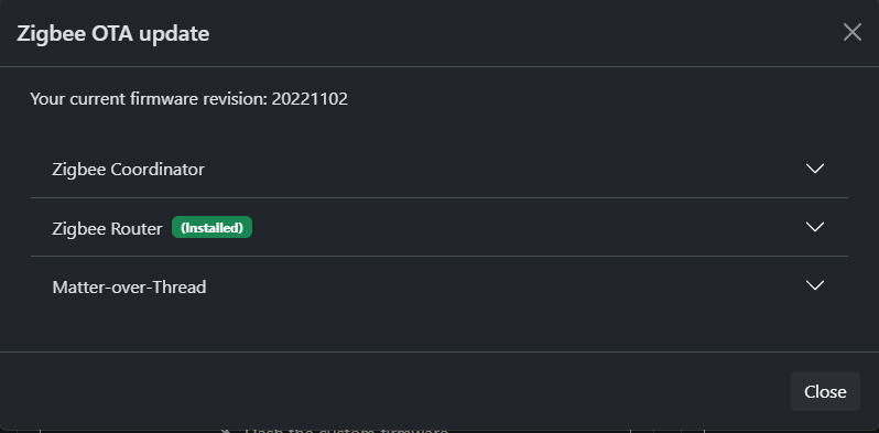

Should coordinator be ‘installed’ ?
Yes sir! That is probably the source of your issues
The router option is for ZigBee networks with multiple dongles. You can only have one main coordinator unless you make changes explained here :arrow_down:
Ok, so I have picked the most recent version not indicated to mess with the pan-id.
It installed fine.
A reboot and we are back in action.
