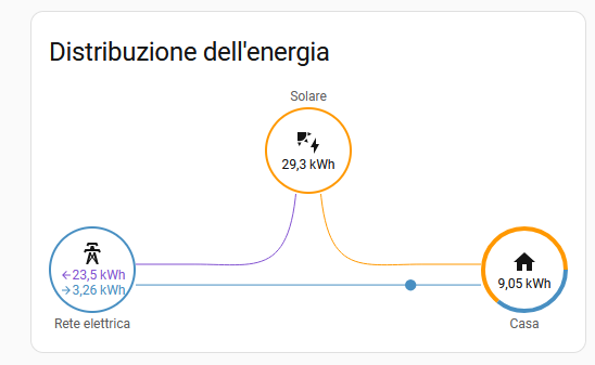

Hi Guys, i hope this is not OT, i am a noobie of HA, i literally just installed yesterday, i setup my sunnyboy on HA, and now i’m trying to get the energy management graphs, but it seems to work only with how much energy i’ve produced/used and exported (Wh), i’d like to have that graph with the current power (W), but i can’t find any way, because i can only select argument with a progressive number as far as i’ve seen. is there a way as far as someone knows?
