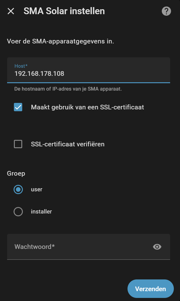

I’ve had first also this problem but after a few try’s
got a connection with the settings in the picture with the correct IP adress and password.
