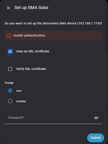

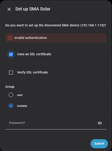

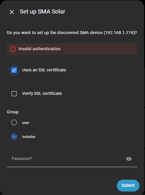

When in HA, I want to add the SMA, it requests a password, so I enter the password used. With use SSL verification and/or verify SSL checked or unchecked it fails (or failed to connect or authentication failed) whether I use user or installer.

As you can see, based on your settings, authentication fails neveertheless :frowning:

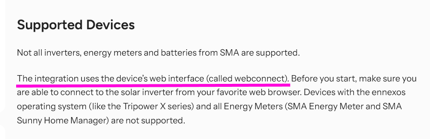

Reading the whole article, I know see “Devices with the ennexos operating system (like the Tripower X series) and all Energy Meters (SMA Energy Meter and SMA Sunny Home Manager) are not supported.”
my device has a ennexos operating system hence that will the reason ro it.

Interesting, I downloaded the datasheet for your inverter and it said:
Which looked like it was supported:
I did not consider the bit about ennexos.
