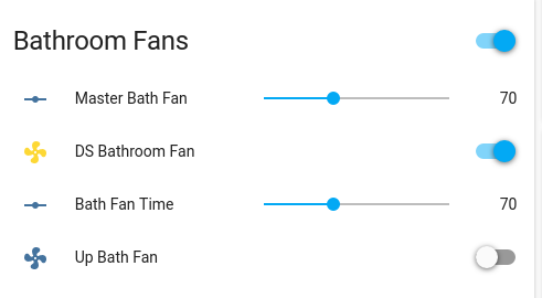

I use a ds18b20 connected to a wemos d1 mini running easyESP. The temp sensor is taped to the hot water line which feeds the shower. There is a Z-Wave switch for the bathroom fan. The bathroom fan has a humidity sensor built in which works fine in the summer but runs too much in the winter. If you turn the fan on it will be in auto humidity mode. If you turn it on, off, and on again the fan will be turned on in manual running mode. The automation based on the water pipe temperature turns on the fan when the temperature is above 92 F and a six minute delay. The delay of the temperature crossing 92 F and the six minutes added delay avoids the drafts from the fan which my wife does not like.
Fan time slider automation which does the turn off:
There is a dash button in the bathroom in case the fan is needed for non shower reasons. This turns off the fan to get it in a known state to then do the on-off-on to get it in full manual on mode.
