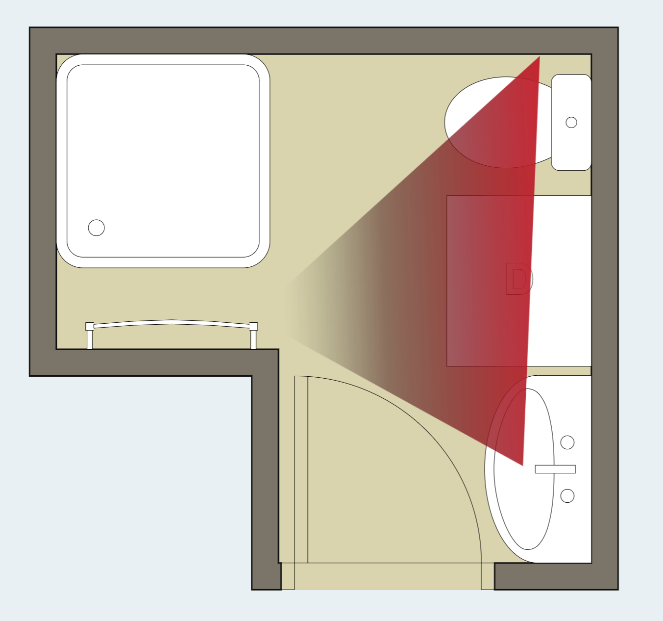

:brain: Motion Sensor Tips
  • Placement is key: The motion sensor should not be triggered by someone just walking past the door or standing outside. Ideally, install it on the ceiling or corner inside the room, angled away from the door.
  • Cooldown (clear delay): Recommended 10–15 seconds to ensure smoother transitions and avoid flickering.

Wow, this looks promising! I’ve also spent a lot of time designing an automation for our bathroom lights (not on HA, though, on a different system) and I know how tricky it is to include all the edge cases.
The first thing that comes to mind is that many motion sensors don’t detect motion continuously but once they detected motion, they won’t detect new motion for a certain time period, e.g. 30 seconds. In practice, this means that you can never assume that you really know the state of the room at any particular moment. You always have to wait at least 30 seconds before you can tell. For example, some opens the door, and makes a quick step. Usually, this will trigger the motion sensor, telling you that someone has entered. However, if that person leaves again after a second and closes the door and another person within 30 seconds opens the door again and enters, no motion will be detected for almost 30 seconds.
Have you considered this in your logic?
Another one of my favourite pitfalls is that here is also a light switch that some people may use. This led to the following situation: when someone turns off the light before they open the door, opening the door would turn the light back on. I think I solved this by turning the door sensor off once the light is on and turning it back on 15 seconds after the light goes off. But even that is not completel fail proof, because it does happen that someone turns off the light, leaves the room but within 15 seconds, someone enters the room again. In that case neither the door sensor will turn on the light (because it is still deactivated) nor the motion sensor (because it is probably still set to “motion detected” from the previous occupant) so that the new entry won’t be registered until up to 30 seconds later…
First of all, I set the cooldown time of the zigbee motion sensor to 10 seconds. I thought that reducing this time would make the automation check more frequently and give more stable results. Also, when I use the automation, I put the switch in detach mode.
In this blueprint, the automation predicts that the door will close within 6 seconds after motion is detected. If motion is detected after someone opens the door and the door is closed within the next 6 seconds, it means the room is occupied.
It is also important that the motion sensor does not detect the door when it is opened. Therefore, the position of the motion sensor should be such that it does not see the door.
As you said, this type of automation is complex and difficult. I am trying to decide whether there is someone inside by closing the door.
I have encountered some bugs even in this. That is why I am still in the development phase. In some cases, people in the house complain that the light does not turn on or goes off while they are inside. I think the usage after the door is left open causes problems.

Love the automation! But I have come across a issue; when I leave the bathroom and someone else enters without closing the door first the light turns off after a short delay (the helper does not turn off and motion is detected by the motion sensor).
New Update: 03.09.2025 - 23:58
Please test this version and give me feedback. I think it is ok. Just create four boolean helper and set from blueprint.
This is my motion sensor position. (Sonoff SNZB-03P)
I have sonoff door sensor on my bathroom door.
