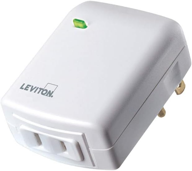

My last scenario is a wall lamp. I would like a wall plug dimmer that Home Assistant can control that I can plug a lamp into?

You mean like a wall wart you plug the lamp into? I’ve got a couple of these in my house, and I have no complaints:
This one is for North American plugs/voltage, I don’t know if they have other version.
