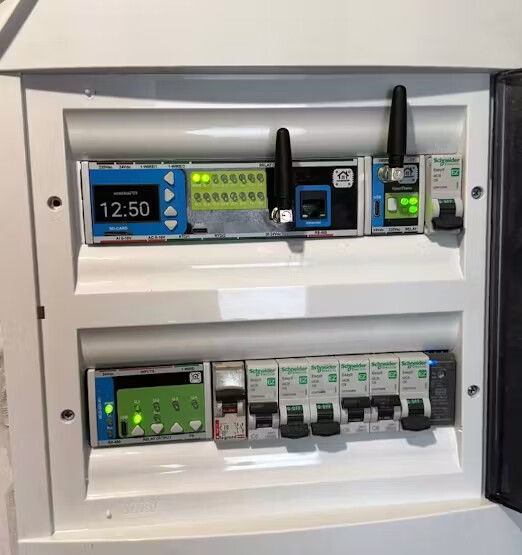

Core Components & Logic Automation
The automation system is built around two main devices:
  • A MiniPLC, which acts as the Modbus RTU master and executes all system-wide control logic.
  • A WLD-521-R1 module, which serves as a smart Modbus slave for all water- and leak-related I/O, as well as flow metering and thermal energy tracking.
All logic is handled locally by the MiniPLC, while the WLD-521-R1 autonomously supervises flow inputs, leak sensors, and provides data for heat energy calculations — all accessible via Modbus.

MiniPLC
The MiniPLC acts as the central controller and Modbus RTU master, executing all automation logic and system coordination.
  • RS-485 Modbus Master
  • Polls the WLD-521-R1 for flow, leak, and temperature data
  • 1-Wire Temperature Sensors BUS1: (T1, T2 – Water jacket surface temperatures
  • 1-Wire Temperature Sensors BUS2: (T3, T4 – Chimney air temperatures T8 – Fresh air inlet temperature)
  • Relay1 → Pump 1 (Primary circulation pump)
  • Relay2 → Pump 2 (Secondary/booster or tank pump)
  • Relay3 → 3-Way Valve (heating circuit or tank)
  • Relay4 → Fan 1 (Fresh Air Fan)
  • Relay5 → Fan 2 (House Air Fan)
  • Relay6 → Gas Heater (backup heating element)
The MiniPLC runs all core control logic for chimney operation, heat routing, pump/valve sequencing, and system safety.

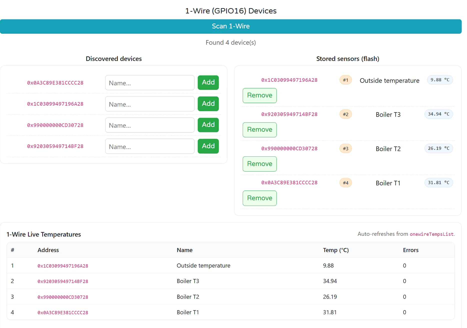

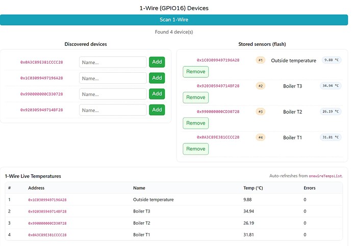

WLD WebConfig — 1-Wire setup :slight_smile:
This screen is where I register the temperature probes on the WLD-521-R1. After clicking Scan 1-Wire , the module lists ROM IDs under Discovered devices . I assign a friendly name and click Add so each probe moves into Stored sensors (flash) with a numbered position (#1#n ). Those positions are later selected in the Heat/ΔT configuration (e.g., A = supply , B = return ).
The 1-Wire Live Temperatures table auto-refreshes with current readings and error counters. Here you can see Outside temperature and Boiler T1/T2/T3 updating with 0 errors —handy for confirming wiring and sensor order before enabling heat-energy calculations on the flow input.
Note on names vs. main schematic: in this screenshot the labels don’t match my main scheme. The correct mapping is:
  • T3 = Supply water (from chimney jacket to loop)
  • T2 = Return water (back from loop)
  • T1 = Water after tank (tank outlet to loop)
The Outside temperature probe is included for visibility on the main dashboard only; it is not used in the control logic .

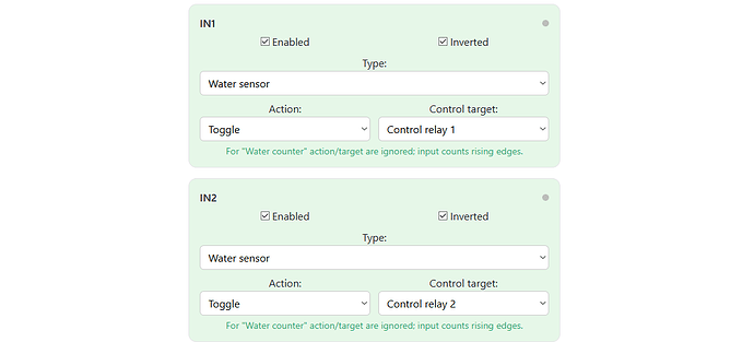

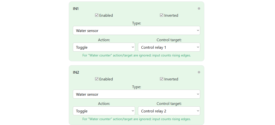

Water leak detection in WLD module:

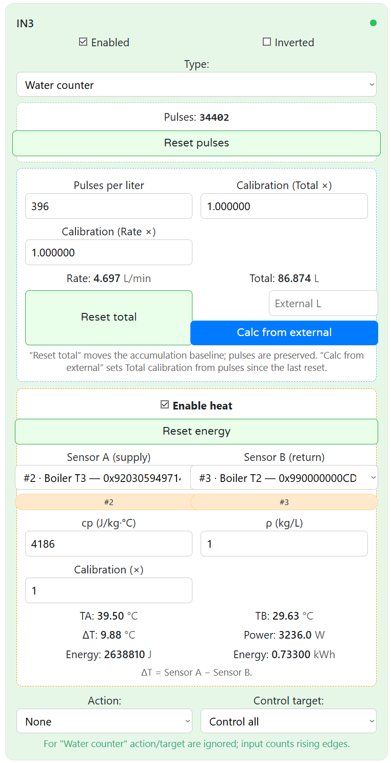

WLD WebConfig — DI3 (Flow + Heat/Energy):
This card shows IN3 configured as a Water counter for the heating loop flow meter.
  • Pulses per liter: 396 (meter constant).
  • Calibration: both Total × and Rate × at 1.000000 (no scaling).
  • Live values: Rate ≈ 4.697 L/min, Total ≈ 86.874 L.
  • Buttons: Reset pulses (raw counter), Reset total (moves the liters baseline), and Calc from external (derives Total× from a known external volume since last reset).
  • Heat/ΔT enabled on this input
Heat calculation is turned on so the WLD can compute thermal power/energy from the same flow plus two 1-Wire sensors:
  • Sensor A (supply): Boiler T3 → TA = 39.50 °C
  • Sensor B (return): Boiler T2 → TB = 29.63 °C
  • ΔT: 9.88 °C (= A − B)
  • Fluid properties: cp = 4186 J/kg·°C, ρ = 1.0 kg/L, Calibration × = 1
Outputs (live): Power ≈ 3236 W, Energy = 0.733 kWh

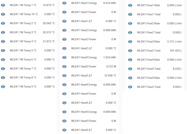

Home Assistant Integration
Data is exposed (temps, flows, leaks, etc) in HA
This panel shows the values the MiniPLC reads from the WLD-521-R1 over Modbus and exposes to Home Assistant:
  • 1-Wire temperatures (#1#10): live °C values from the WLD’s 1-Wire list (e.g., Temp1 ≈ 10.875 °C , Temp2 ≈ 20.063 °C , Temp3 ≈ 20.313 °C , Temp4 ≈ 21.813 °C ; unused channels report 0.000 °C).
  • Heat channels (Heat1…Heat5): each provides Energy (kWh) , Power (W) , and ΔT (°C) for a paired flow+temperatures input.In this snapshot, Heat3 is active: Power ≈ 5, 122 W , ΔT ≈ 13.938 °C , Energy ≈ 1.523 kWh ; other heat channels are idle.
  • Flow counters (Flow1…Flow5): Rate (L/min) and Total (L) from pulse inputs.Here Flow3 shows ≈ 2.121 L/min and 161.422 L total ; Flow1/2/4/5 are at 0.000 L/min with their respective totals (e.g., Flow4 total 8.220 L , Flow5 total 0.003 L ).
This view is handy for quick health checks: temps are updating, the active heat channel’s ΔT/Power align with Flow3 , and any zero/flat readings are obvious if a sensor or meter goes offline.

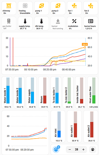

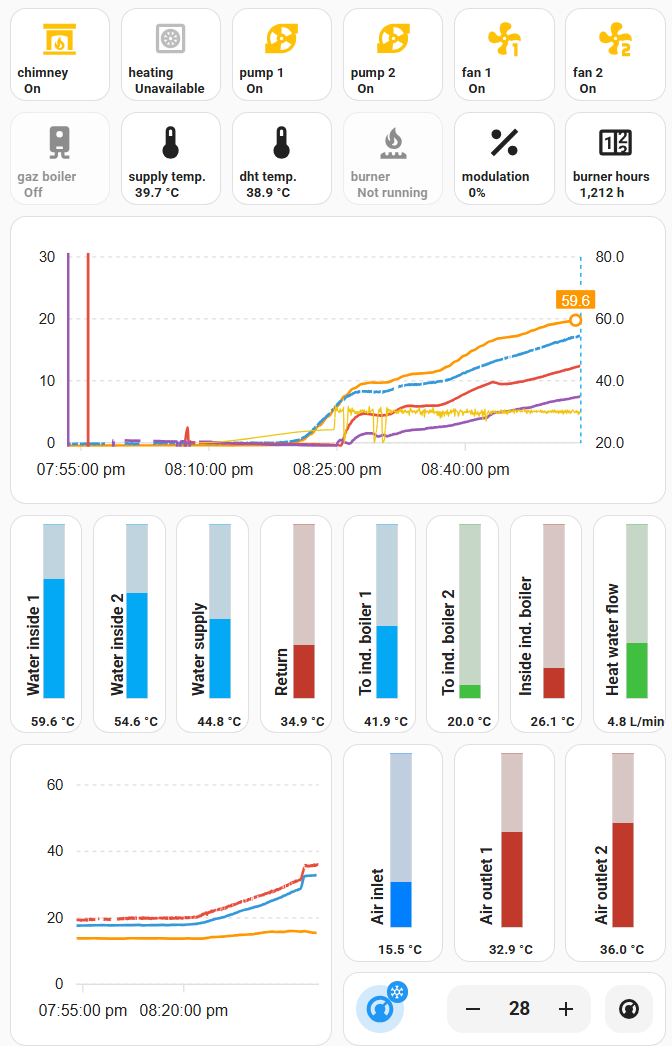

Home Assistant — Chimney & Water Automation Dashboard
This is the single pane I use to monitor and validate the whole setup: chimney, hydronic loop, buffer tank, air heat-exchanger, and gas backup.
  • Top status chips: live states for the chimney, heating demand, Pump 1 and Pump 2, Fan 1 and Fan 2, and the gas boiler (including burner status, modulation, and hours). At a glance I can see the chimney is active, both pumps and fans are running, and the gas boiler is off.
  • Warm-up trend (center graph): real-time curves for water temperatures as the burn progresses. Supply rises, the return stays lower, and the spread between them shows the heat being moved.
  • Hydronic bars: Water inside 1 and 2 (jacket temperatures); Water supply and Return (loop); To indirect tank 1 (from chimney) and 2 (from solar collector) plus Inside tank (buffer status); and Heat-water flow in L/min from F3. These tell me whether routing is direct or via the tank and whether flow and ΔT look healthy.
  • Air heat-exchanger section: Air inlet versus Air outlet 1 and 2 shows the temperature gain across the chimney exchanger when the fans are on.
  • Quick controls (bottom right): setpoints for fan start triggers.
Why it’s useful: this layout mirrors the automation flow—warm-up, 3-way valve routing, air-side recovery, and gas-assist lockout—so I can verify in one view that the PLC is doing the right thing and that the WLD meters (flow and energy) match the temperature behavior.

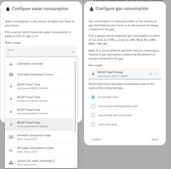

Home Assistant Energy
Adding parameter to the Energy dashboard:
Energy dashboard:Energy & Water Dashboard
Home Assistant doesn’t (yet) have a native “heat energy by source” card for my setup, so I’m using the Energy view to visualize everything together:
  • Gas for heating consumption — energy produced by the gas heater for space heating.
  • Gas for hot-water consumption — gas used only for DHW.
  • Chimney heating energy — heat produced by the chimney (from WLD calorimetry using F3 × (T6–T5)).
  • Solar collector energy — contribution from the solar loop (can be a little negative on recalcs/offsets).
  • Cold/Hot water consumed — totals from the F2/F1 flow meters; shown with a daily/period total.
This lets me compare how much heat the gas heater provides vs. the chimney (and solar), and also track water usage in the same view.
