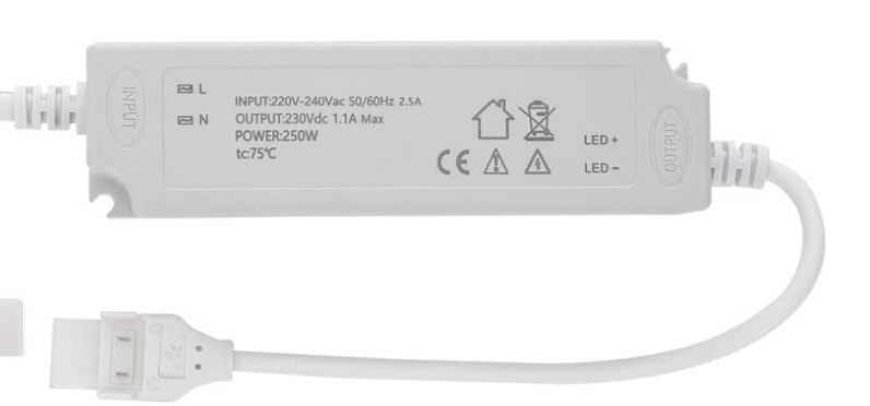

LEDs are current controlled, voltage is not relevant as long as it’s higher than the sum of LED forward voltages in series. High voltage drivers are commonly available, but you need to dig information about the current.

The picture you posted is a constant VOLTAGE driver, so you are contradicting yourself right there. Its even says MAX 1,1A so it will vary depending on the load.
As for the OP: Post some specs about the driver and ledstrip. Otherwise this will end in tears.
I didn’t propose that driver, it was just an example of high voltage driver, showing that 220vdc LEDs are not something weird.
