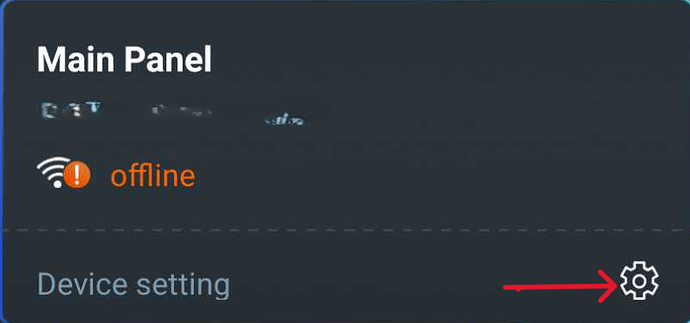

I must be missing something. I can connect to the meter through the app, but it gives no data and there is no switch for HA in their app.
Seems like their servers might be down since going to sem-meter.tumblevd.com just gives {“code”:404,“msg”:“miss”,“value”:}
Yes, their servers seem to be down. The miss is normal because you are not specifying any payload to send to the api. As for the HA Button see these screenshots.
Weird. In addition to their servers I might need a firmware update as well. Thanks for the reply.
I reached out to their support email and apparently all of my issues were due to the metal of the antenna connector touching the breaker box. After fixing it, no more weird multiplier issues and my usage is very similar to my electric companies
Well, their servers are back up and letting it sit overnight seems to have updated the firmware so I have the HA button. Patience is a virtue that I often lack.
