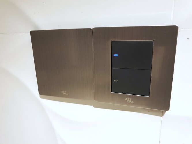

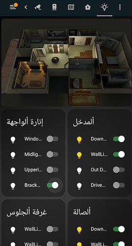

let’s start with lighting, instead of replacing traditional wall switches with smart switches, I added smart zigbee control from tuya (mini type) that fits behind the main switches, by this way i kept all switches and sockets in same style and reduce the cost,
From here I was able to control lights and make automations that turn on/off exterior light depends on sun and turn on/off interior lights in specific times, also set timer to turn off bathroom light and discharge fan after period of time

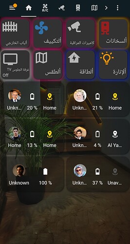

last but not least, I benefited a lot from mobile tracking via owntracks, through it i was able to make a lot of interesting automations like open driveway gate when i reached home zone and turn on interance lights in night, also turn off bedroom ac etc…
