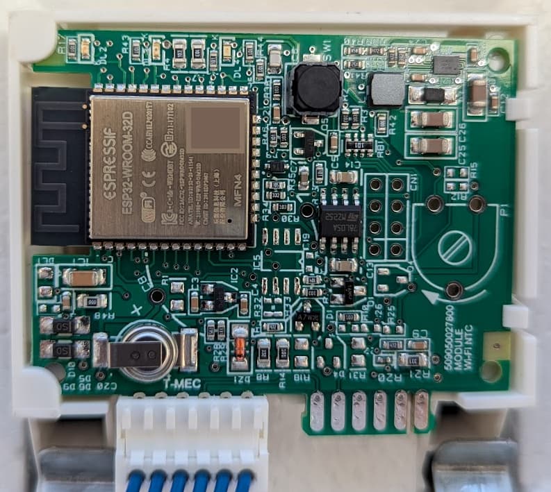

The firmware does run on an ESP chip but it’s their own firmware, not Tuya. You could likely serial flash it with ESPHome. Just be sure to dump the original firmware in case you want to flash it back again.

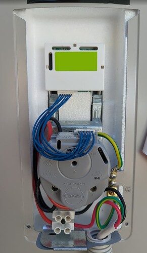

Obviously be careful if you open yours without isolating it (mains voltage), but some photos from my unit.
