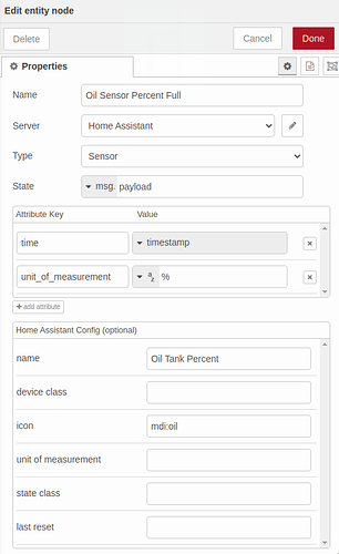

Can you post your entities code by any chance? I’ve been struggling with trying to get the data to get represented in a histogram, but it only wants to show me a bar graph…

"property": "name",
"value": ""
"property": "device_class",
"value": "gas"
"property": "icon",
"value": ""
"property": "unit_of_measurement",
"value": ""
"property": "state_class",
"value": ""
"property": "last_reset",
"value": ""
"state": "payload",
"stateType": "msg",
"attributes": [],
"resend": true,
"outputLocation": "payload",
"outputLocationType": "none",
