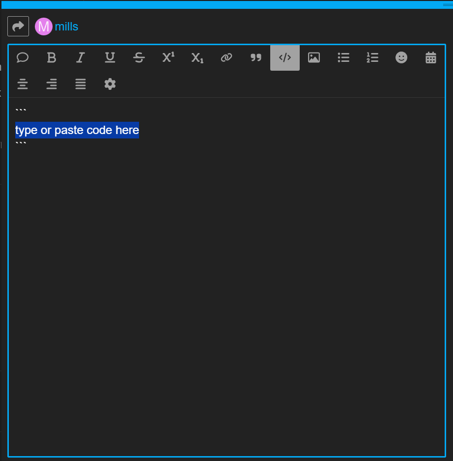

copy the yaml code from your automation and paste in your reply between the dots, example below.

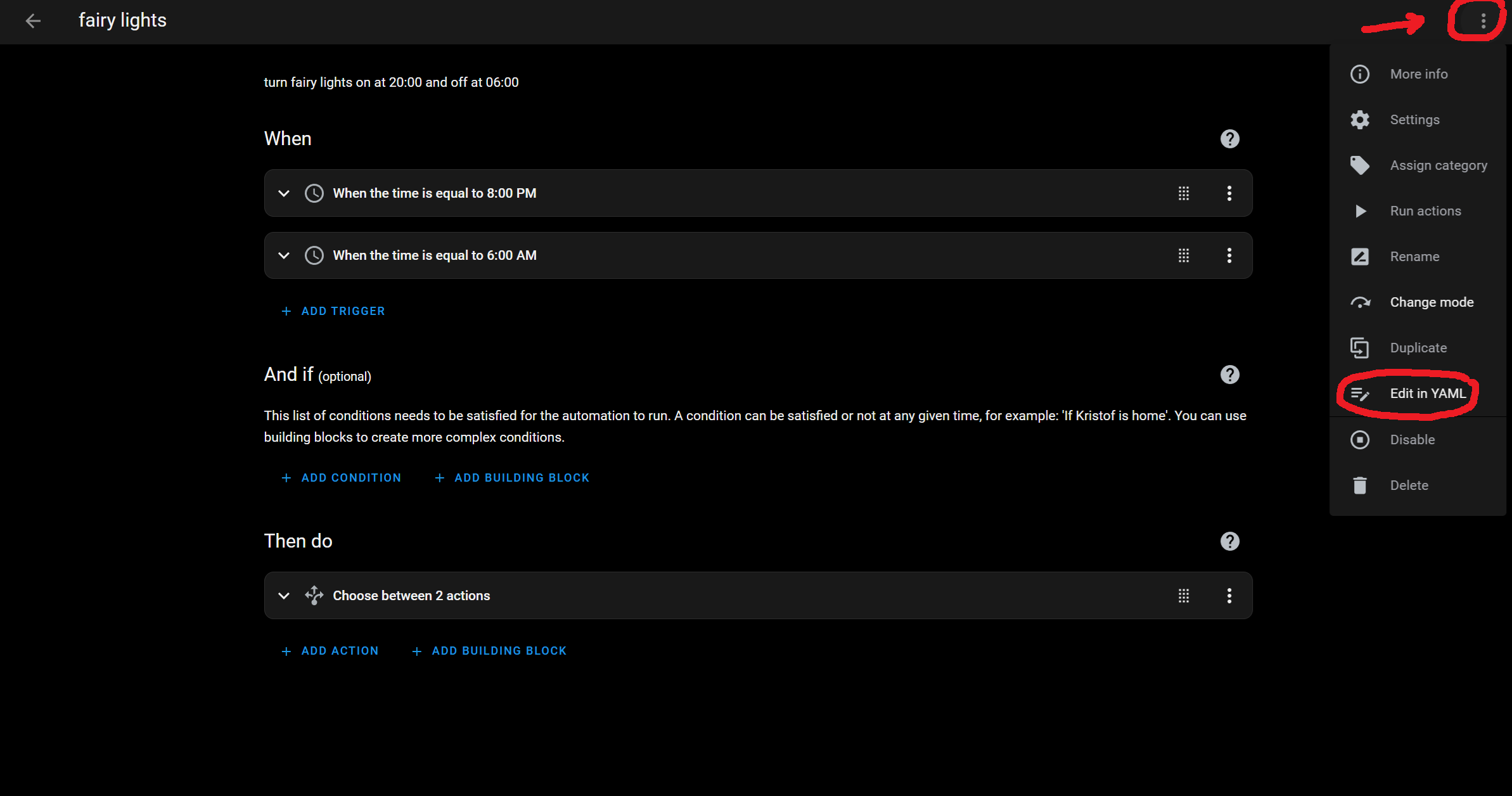

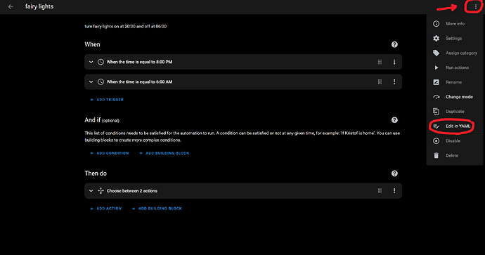

if your not sure how to copy the code into your automation, here is how:
first edit your automation and go to the 3 dots at the top right, click on it and select “Edit in YAML”.
select all and delete your code, then paste my code and save.

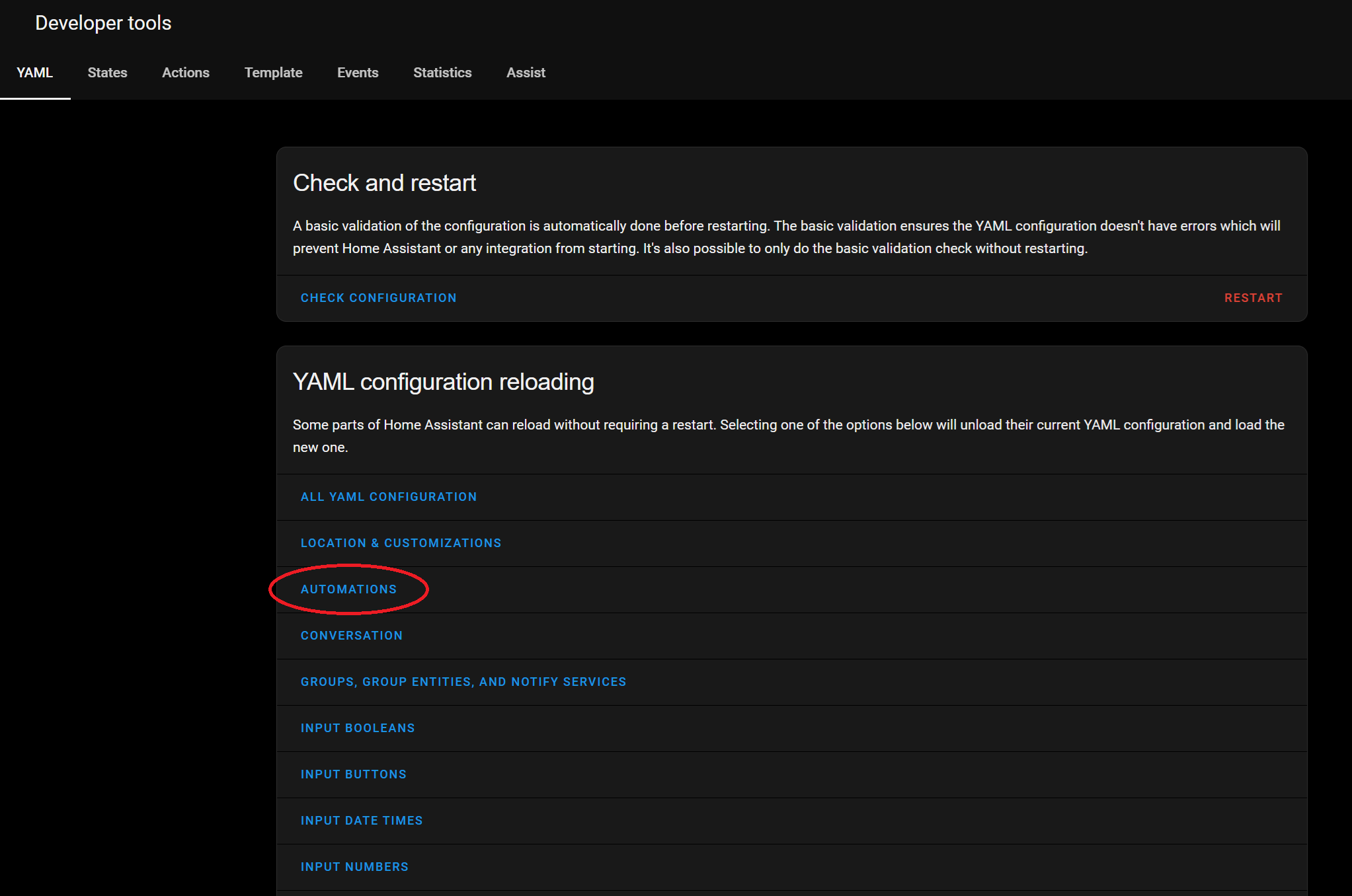

finally go to developer tools and reload the automations.
Finally it works.
