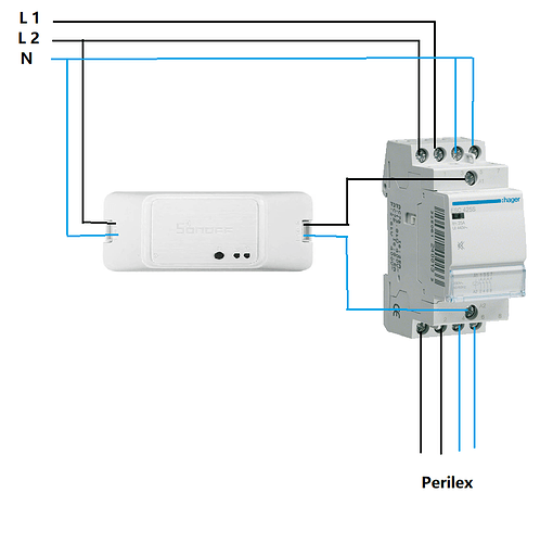

Is there also a version for perilex plugs?
So far I have never seen a smart Perilex plug
Your Perilex wall outlet is a straight cable out of your fusebox (meterkast).
You can use a “dumb” 3-phase contactor and switch it’s relays with a simple 1-phase smart switch all placed in the fusebox.
Not sure, how a 3-phase power meter will react to it. It should work fine, when the 2 phases in your Perilex are two DIFFERENT phases (like L1 and L2).
If they are both the same phase (like L1 and L1), you could use 2 pieces of 1-phase meters and then make a sum of the two readings.

Is there also one (perilex) that doesn’t measure and is cheaper for that reason?
The easiest and cheapest, but still safe and reliable way - 3 phase contactor and a simple wifi switch.
Materials:
https://www.elektroschakelmateriaal.nl/products/hager-esc425s-magneetschakelaar-25-a-4-maak-geruisarm-230v-ac-50-60hz-107961
Connection (inside your fusebox):
Have a look at:
