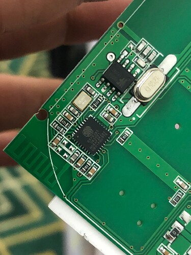

UPDATE: turns out it is an ESP after all. A quick MAC Address reverse search revealed so:
Found out the chip inside. It was an ESP8285 chip. I got the new one up and running though.
Here is the chip close up, no esp header pins exposed on the PCB though.
Looking at the pinout of the 8285 then I belive you have IO0 and TX on this side.
Probably you got RX on the other side:
There seems to be a lot of holes above the chip, that is probably the exposed pins, they are just unmarked.

Just as I posted I realised the pin is probably here:

If this is the same one i have, this is the pinout
From left, 3.3v, rx, tx, gpio00, reset, gnd
holy sh** this is the exact thing, thanks man! i actually noticed the ones at front but since they were unmarked, i didnt think it was the one im looking for. But since you verified it, that makes sense!
I’ll try to further verify incase they made different pinout layout, just in case.
