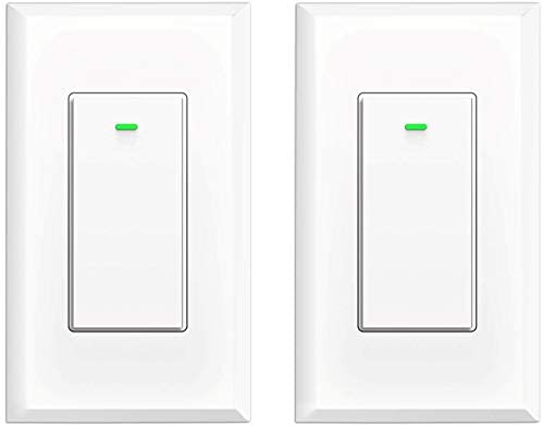

I am not familiar with the shelly’s capabilities, but something I have been finding useful recently is using the double tap function in tasmota to add additional controls from a single switch. (single tap turns off the connected light, double tap controls a completely independent light or triggers and automation, etc.)
I have been flashing these and find them rather stable and you still have a ‘normal’ looking switch. Price is a bit more than the base model shelly though.
