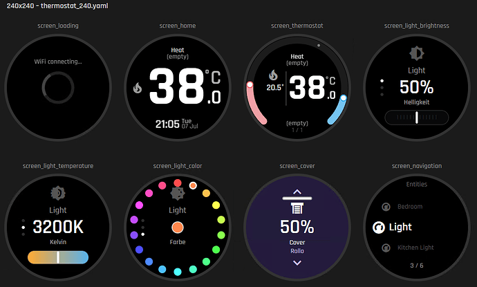

A round rotary smart display that controls your thermostat, lights, and covers straight from Home Assistant — no phone, no app, just a knob you turn and press. It’s fully open-source ESPHome firmware built for Elecrow’s CrowPanel ESP32-S3 rotary displays, with an optional HACS integration so you never have to hand-write YAML to configure it.
I wanted something that felt like a real Nest-style thermostat on the wall, but that could also drive my lights and rollershutters without switching apps — so I built this over the last while and I’m finally happy enough with it to share.
What it does
  • Thermostat: current + target temperature, HVAC mode, presets, single- or dual-setpoint climate entities (TRV + AC combos included). It’s tuned to work well with Better Thermostat — I run Better Thermostat myself and this is exactly what I built it against.
  • Lights: brightness, color temperature, and full color, each with its own screen.
  • Covers: position control, stop, and a one-swipe full open/close — including covers that only support open/close/stop (no set_position).
  • One shared entity overview screen to jump between every configured thermostat, light, or cover.
  • Rotary encoder + touch for input, live Home Assistant connection status on-screen.
  • Flash it straight from your browser and set up Wi-Fi right there too (Improv Wi-Fi, no ESPHome install needed) — more on that below.
No Home Assistant automation YAML required — the firmware talks to HA directly over the native ESPHome API.

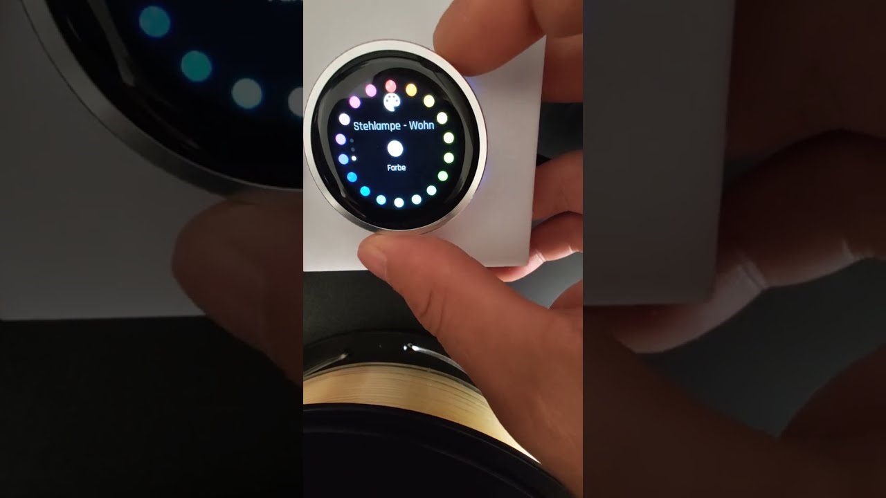

Video walkthrough
240x240 board in action:
(480x480 walkthrough coming soon)
