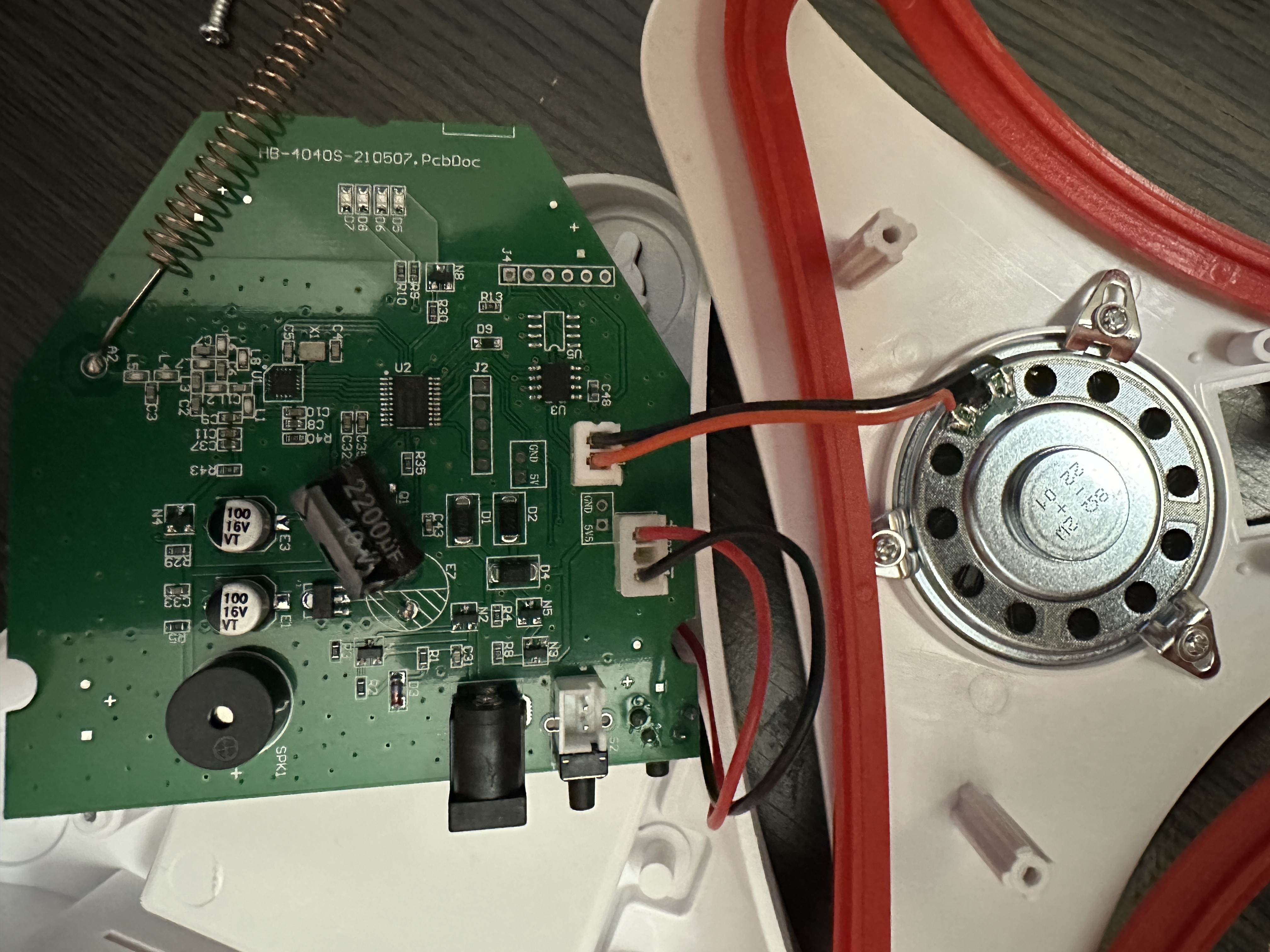

Voltage detection could work. If you can provide the voltage levels, I can help further. A picture of the circuit board would also be helpful.
Sorry for the late reply, I have attached a picture of the board
I think your best bet is to poke around with a multimeter and try to find an “enable signal”. Basically you need a trace that turns on or off when the sensor is triggered.
