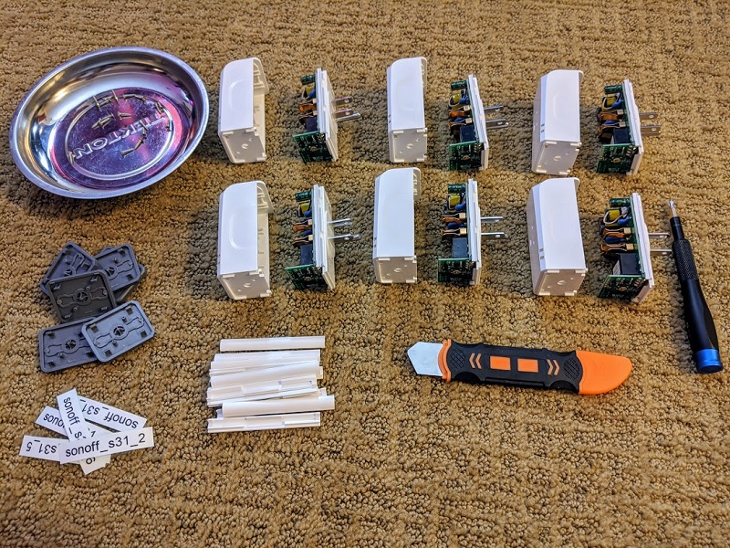

This project to replace my Z-Wave smart plugs came about because I was frustrated with the intricacies of Z-Wave, disappointed in the stability, accustomed to state reporting errors, and had a hard time justifying the expensive hardware cost.
