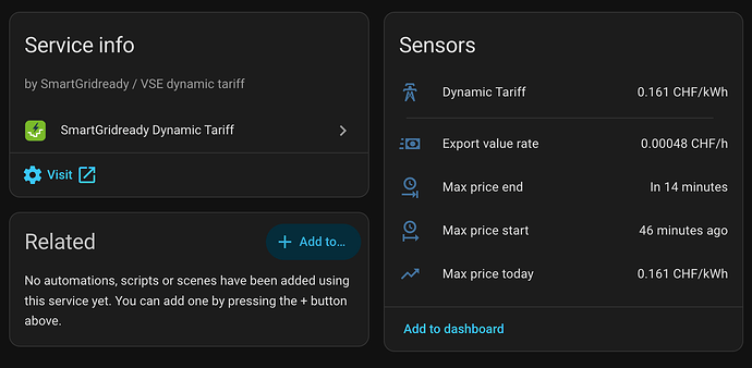

Screenshot
device page showing the Dynamic Tariff, Export value rate, Max price today/start/end sensors
