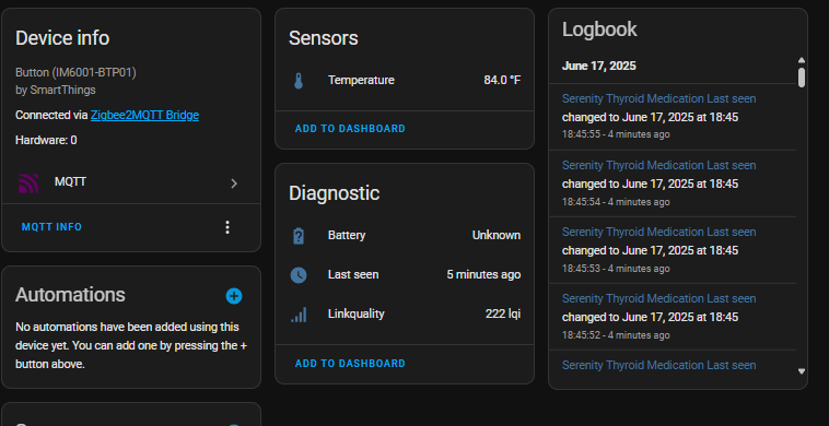

SmartThings IM6001-BTP01 button
Looking at the above link, action appears to be supported.
“last_seen”: “2025-06-17T22:51:56.193Z”,
“linkquality”: 217,
“temperature”: 28.87,
“voltage”: 2900,
“battery”: null,
“action”: “single”
Zigbee2MQTT is able to view the button’s actions, Home Assistant is not.
Just to be sure, I restarted Home Assistant.
I researched Reddit and this forum; I did not find anyone else having this issue or posting that they have this issue. If I need to upload logs, please tell me where to go to get these logs.
I removed the device and re-added it.
Reconfigured/Reinterviewed.
The action is not showing.
I am using Zigbee2MQTT, not the Samsung SmartThings integration.
I do have SmartThings, but not using it and not even plugged in.
I wish not to use ST. If this button is not compatible with Home Assistant, I will simply return it to Amazon and get another Zigbee button.
Thanks!
