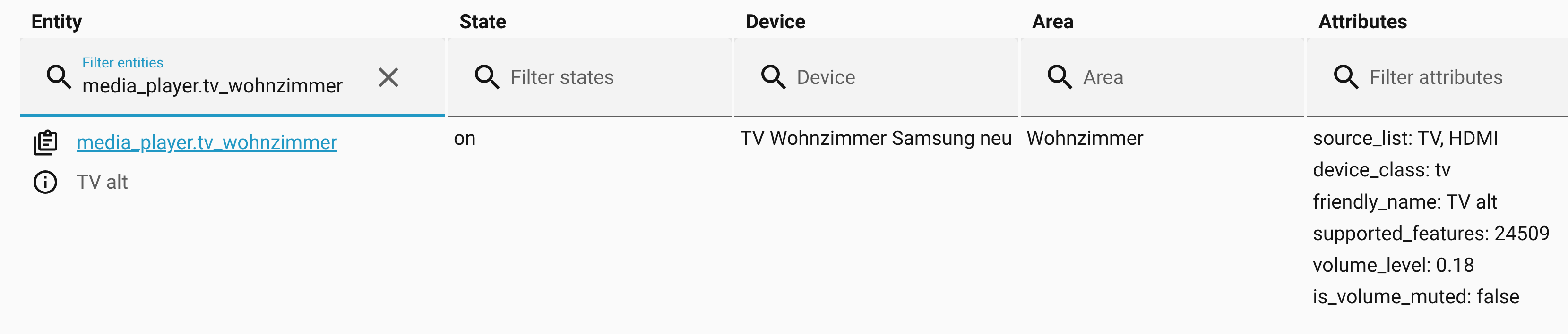

Tried that and unfortunately you don’t get much through the attributes:
I half expected that based on your previous reply. Looks like your TV doesn’t expose the channel as part of the attributes :man_shrugging:
