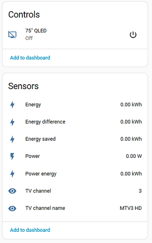

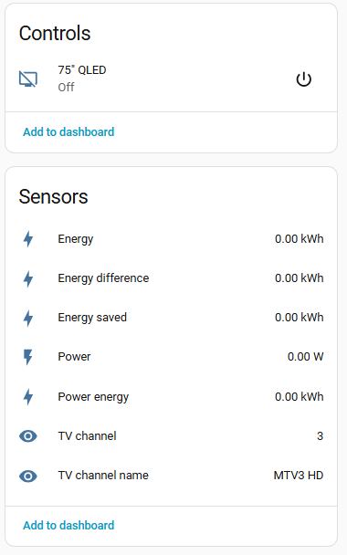

Sorry, missing that info. Here is how smartthings show that channel name information. Its coming from Samsung cloud api attribute tvChannelName:
That other Samsung integration does not have that option

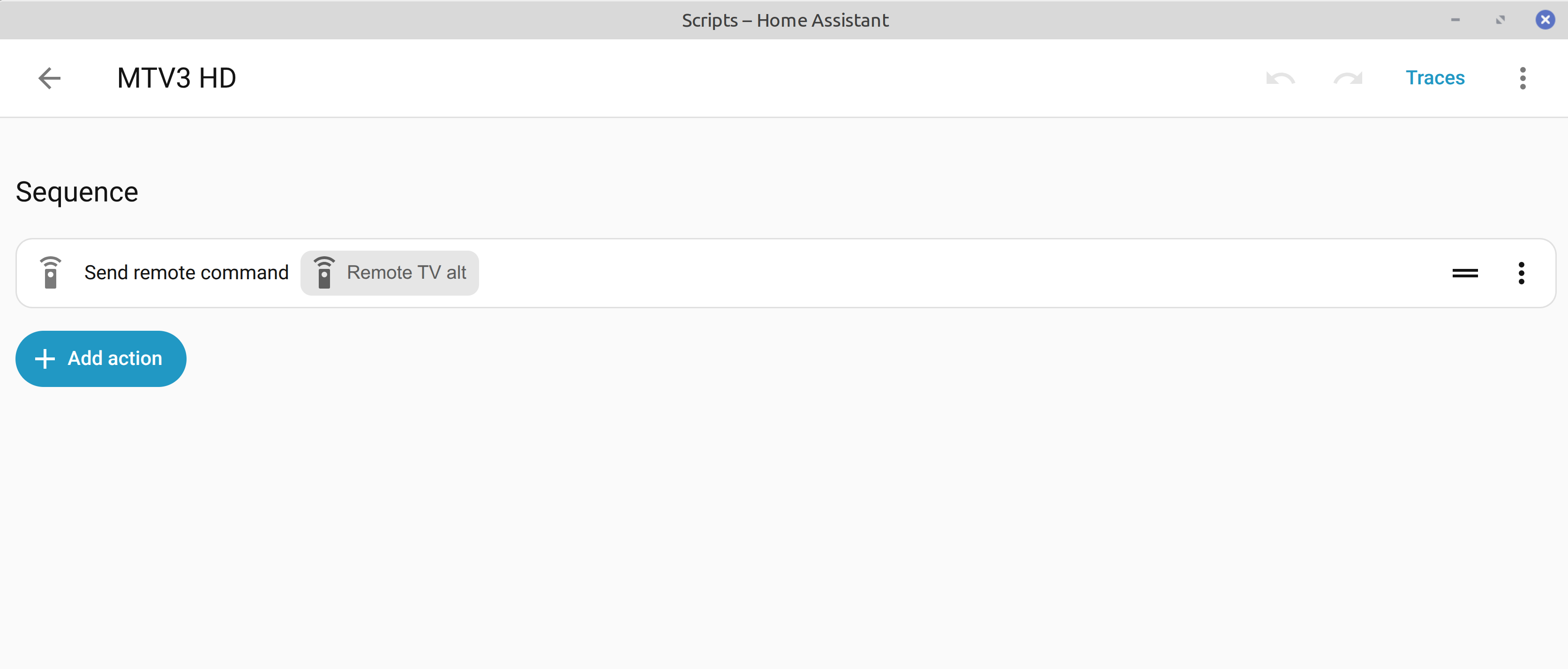

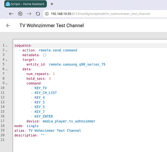

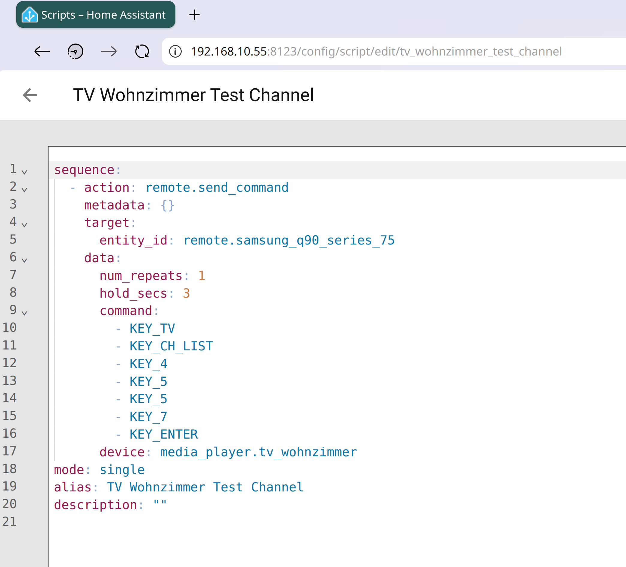

You want a button in HA (named MTV3 HD) - that when you click on it calls up that TV station on your TV?
In that case
  • just note down the number of that channel you would like to select - in my example I am going to use channel nr. 4557
  • write a little script in HA with the following content
  • rename the script to MTV3 HD
and now you can run that script any way you want from HA - for example attach it to a button, or use matter-hub and voice command through alexa, make an icon to click on, etc. etc.

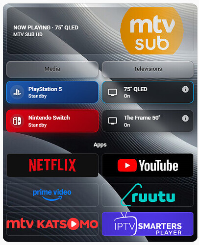

No, i want info for my card when i change channel on tv and it should show in card what channel is on tv.
