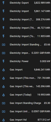

I had them fit mine last year. The Octopus custom component in HA reports them as
Electricity: 31324131 by 1125 - Shenzhen Kaifa Metering
Gas: 10F2A100 by 106C - EDMI Metering Europe
I get all the meter data from that custom component. I also have the Octopus Home Mini which gives near as possible real time data (for electricity, gas is approx every 30 mins)
Entitles in HA:
Electric Import
Electric Export
Gas
I’ve also got the Hildebrand Glow IHD which interfaces directly to the meters so works independently to Octopus. There’s also a custom component for that too
Entitles in HA:

If you are with Octopus then you’d be ok as is. The mini only gives the extra instant power draw/export. It’s free (but takes a while to come) so may as well get one. Also you get more data direct from Octopus - standing charge, current rate etc (see above)
