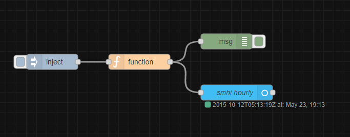

In case anyone wants to use the API and Node red then this should give you a sensor with the hourly temperatures.
[{"id":"e8c4886bfa53473a","type":"debug","z":"4eb25acf17389316","name":"","active":true,"tosidebar":true,"console":false,"tostatus":false,"complete":"true","targetType":"full","statusVal":"","statusType":"auto","x":510,"y":660,"wires":[]},{"id":"fba7c704f5e5ed3a","type":"inject","z":"4eb25acf17389316","name":"","props":[{"p":"payload"}],"repeat":"","crontab":"","once":false,"onceDelay":0.1,"topic":"","payload":"{   \"approvedTime\":\"2015-10-12T05:13:19Z\",   \"referenceTime\":\"2015-10-12T03:00:00Z\",   \"geometry\":{     \"type\":\"Point\",     \"coordinates\":[       [         16.017767,         57.999628       ]     ]   },   \"timeSeries\":[     {       \"validTime\":\"2015-10-12T04:00:00Z\",       \"parameters\":[         {           \"name\":\"msl\",           \"levelType\":\"hmsl\",           \"level\":0,           \"values\":[             1031           ]         },         {           \"name\":\"t\",           \"levelType\":\"hl\",           \"level\":2,           \"values\":[             3.1           ]         },         {           \"name\":\"vis\",           \"levelType\":\"hl\",           \"level\":2,           \"values\":[             18           ]         },         {           \"name\":\"wd\",           \"levelType\":\"hl\",           \"level\":10,           \"values\":[             26           ]         },         {           \"name\":\"ws\",           \"levelType\":\"hl\",           \"level\":10,           \"values\":[             0.2           ]         },         {           \"name\":\"r\",           \"levelType\":\"hl\",           \"level\":2,           \"values\":[             95           ]         },         {           \"name\":\"tstm\",           \"levelType\":\"hl\",           \"level\":0,           \"values\":[             0           ]         },         {           \"name\":\"tcc_mean\",           \"levelType\":\"hl\",           \"level\":0,           \"values\":[             6           ]         },         {           \"name\":\"lcc_mean\",           \"levelType\":\"hl\",           \"level\":0,           \"values\":[             6           ]         },         {           \"name\":\"mcc_mean\",           \"levelType\":\"hl\",           \"level\":0,           \"values\":[             0           ]         },         {           \"name\":\"hcc_mean\",           \"levelType\":\"hl\",           \"level\":0,           \"values\":[             0           ]         },         {           \"name\":\"gust\",           \"levelType\":\"hl\",           \"level\":10,           \"values\":[             1.1           ]         },         {           \"name\":\"pmin\",           \"levelType\":\"hl\",           \"level\":0,           \"values\":[             0           ]         },         {           \"name\":\"pmax\",           \"levelType\":\"hl\",           \"level\":0,           \"values\":[             0           ]         },         {           \"name\":\"spp\",           \"levelType\":\"hl\",           \"level\":0,           \"values\":[             -9           ]         },         {           \"name\":\"pcat\",           \"levelType\":\"hl\",           \"level\":0,           \"values\":[             0           ]         },         {           \"name\":\"pmean\",           \"levelType\":\"hl\",           \"level\":0,           \"values\":[             0           ]         },         {           \"name\":\"pmedian\",           \"levelType\":\"hl\",           \"level\":0,           \"values\":[             0           ]         }       ]     },     {       \"validTime\":\"2015-10-12T05:00:00Z\",       \"parameters\":[         {           \"name\":\"msl\",           \"levelType\":\"hmsl\",           \"level\":0,           \"values\":[             1030           ]         },         {           \"name\":\"t\",           \"levelType\":\"hl\",           \"level\":2,           \"values\":[             3.4           ]         },         {           \"name\":\"vis\",           \"levelType\":\"hl\",           \"level\":2,           \"values\":[             16           ]         },         {           \"name\":\"wd\",           \"levelType\":\"hl\",           \"level\":10,           \"values\":[             99           ]         },         {           \"name\":\"ws\",           \"levelType\":\"hl\",           \"level\":10,           \"values\":[             0.7           ]         },         {           \"name\":\"r\",           \"levelType\":\"hl\",           \"level\":2,           \"values\":[             95           ]         },         {           \"name\":\"tstm\",           \"levelType\":\"hl\",           \"level\":0,           \"values\":[             0           ]         },         {           \"name\":\"tcc_mean\",           \"levelType\":\"hl\",           \"level\":0,           \"values\":[             7           ]         },         {           \"name\":\"lcc_mean\",           \"levelType\":\"hl\",           \"level\":0,           \"values\":[             7           ]         },         {           \"name\":\"mcc_mean\",           \"levelType\":\"hl\",           \"level\":0,           \"values\":[             0           ]         },         {           \"name\":\"hcc_mean\",           \"levelType\":\"hl\",           \"level\":0,           \"values\":[             0           ]         },         {           \"name\":\"gust\",           \"levelType\":\"hl\",           \"level\":10,           \"values\":[             2           ]         },         {           \"name\":\"pmin\",           \"levelType\":\"hl\",           \"level\":0,           \"values\":[             0           ]         },         {           \"name\":\"pmax\",           \"levelType\":\"hl\",           \"level\":0,           \"values\":[             0           ]         },         {           \"name\":\"spp\",           \"levelType\":\"hl\",           \"level\":0,           \"values\":[             -9           ]         },         {           \"name\":\"pcat\",           \"levelType\":\"hl\",           \"level\":0,           \"values\":[             0           ]         },         {           \"name\":\"pmean\",           \"levelType\":\"hl\",           \"level\":0,           \"values\":[             0           ]         },         {           \"name\":\"pmedian\",           \"levelType\":\"hl\",           \"level\":0,           \"values\":[             0           ]         }       ]     }   ] }","payloadType":"json","x":170,"y":700,"wires":[["31505c357280d0ec"]]},{"id":"31505c357280d0ec","type":"function","z":"4eb25acf17389316","name":"","func":"var array = {};\nvar time = \"\";\n\nfor (var index in msg.payload.timeSeries) {\n    for (var val in msg.payload.timeSeries[index].parameters) {\n        time = msg.payload.timeSeries[index].validTime;\n        if (msg.payload.timeSeries[index].parameters[val][\"name\"] == \"t\"){\n            array[time] = msg.payload.timeSeries[index].parameters[val].values[0]\n        }\n    }\n}\n\nmsg.arr = array;\nreturn msg;","outputs":1,"noerr":0,"initialize":"","finalize":"","libs":[],"x":340,"y":700,"wires":[["e8c4886bfa53473a","fae9c841252a3911"]]},{"id":"fae9c841252a3911","type":"ha-entity","z":"4eb25acf17389316","name":"smhi hourly","server":"4bbca37b.1700ec","version":1,"debugenabled":false,"outputs":1,"entityType":"sensor","config":[{"property":"name","value":"smhi hourly"},{"property":"device_class","value":""},{"property":"icon","value":""},{"property":"unit_of_measurement","value":""}],"state":"payload.approvedTime","stateType":"msg","attributes":[{"property":"hourly","value":"arr","valueType":"msg"}],"resend":true,"outputLocation":"payload","outputLocationType":"none","inputOverride":"allow","outputOnStateChange":false,"outputPayload":"$entity().state ? \"on\": \"off\"","outputPayloadType":"jsonata","x":530,"y":760,"wires":[[]]},{"id":"4bbca37b.1700ec","type":"server","name":"Home Assistant","version":1,"legacy":false,"addon":true,"rejectUnauthorizedCerts":true,"ha_boolean":"y|yes|true|on|home|open","connectionDelay":true,"cacheJson":true}]
I just used an inject with the example json, but if you use an http request on the json endpoint then it should give all the current data.

Need some help here. I have never used node-red so can’t get it to work. I only get value for 2015 in my sensor. Do I need a automation to fetch value from the node-red automation?
I don’t understand what you are saying.
What do you mean by 2015?
I can upload my current smhi sequence later
